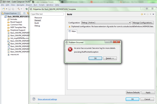

2. When I import the project as a General->Existing Projects into Workspace, The project appears at the Project Explorer view, but i have further problems:
a. When I click on the project properties:

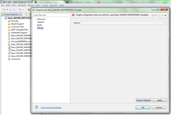

And the debug properties looks like:

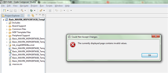

And the funny thing when I click on General:
b. I probably need .ccxml file, but its not included in project. Also, I dont know how to set the target configuration manually for a FET Debugger that was in the set. Do I need to plug the board first?

  • Hi Rafal,
    first let me say, importing as a non CCS Project will not work.
    You need to import and use a CCS Project for things to work for you.  This leaves us with the issue of a blank Project Explorer window.
    There are a couple things you can check and try.  Also, as we have seen this odd behaviour in a couple isolated cases, this is something we are trying to dig into in the background.  However this may not necessarily be related.

    Also, when I click on the Properties->Debug I have an error similar that I had on the CCS5.1.
