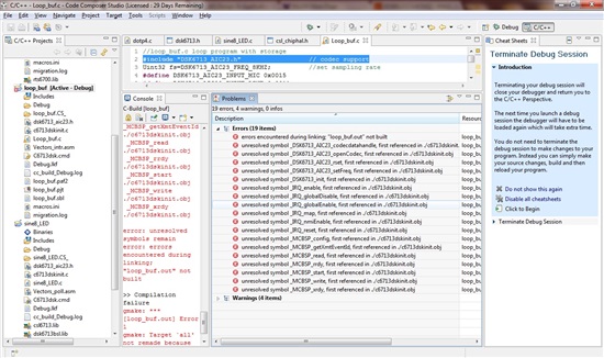

    We have successfully imported projects from CCS v3.1 to CCS v4.2.4. However, when we tried to build the project, it shows some errors as follows.
    undefined                      first referenced
    symbol in file
    _DSK6713_AIC23_codecdatahandle ./c6713dskinit.obj
    _DSK6713_AIC23_openCodec ./c6713dskinit.obj
    _DSK6713_AIC23_rset ./c6713dskinit.obj
    _DSK6713_AIC23_setFreq ./c6713dskinit.obj
    _DSK6713_init ./c6713dskinit.obj
    _IRQ_enable ./c6713dskinit.obj
    _IRQ_globalDisable ./c6713dskinit.obj
    _IRQ_globalEnable ./c6713dskinit.obj
    _IRQ_map ./c6713dskinit.obj
    _IRQ_nmiEnable ./c6713dskinit.obj
    _IRQ_reset ./c6713dskinit.obj
    _MCBSP_config ./c6713dskinit.obj
    _MCBSP_getXmtEventId ./c6713dskinit.obj
    _MCBSP_read ./c6713dskinit.obj
    _MCBSP_rrdy ./c6713dskinit.obj
    _MCBSP_start ./c6713dskinit.obj
    _MCBSP_write ./c6713dskinit.obj
    _MCBSP_xrdy ./c6713dskinit.obj
    Any assistance would be truly appreciated.
    Alex

  • Hello Alex,
    As John mentioned, you should be starting a new thread for each new question. In case you didn't, here are some answers:
    symbol in file
    Looks like you are missing the 6713 BSL lib (dsk6713bsl.lib) that comes with the C6713 DSK target content package zip from spectrum digital. Make sure you add that library to your project so it gets linked in.
