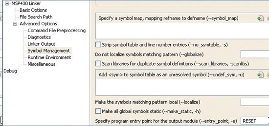

    In regards to the entry point warning for ELF asm projects, please try the following two updates in your CCS project:
    1) Update your asm file to include this line where RESET is the reset vector label name
         .global RESET                                           ; define entry point
    2) Next update CCS project linker options to indicate the --entry_point as RESET
    Greg
  • We have created processorwiki articles for both diagnostics encountered in this article.
    10198
    10202
    Above articles cover all the fixes in this thread as well as adding a missing item of using .retainrefs where above thread indicated to use .retain.  This allows ELF projects to build successfully.  See above links for details.
    Greg
