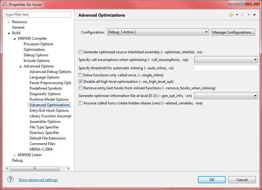

    another thought I had you can check (sorry for yet another reply here).  What optimization settings are you using?  I am wondering whether the optimizer is using registers for these variables, optimizing them out to a sense and causing problems with the debug information.   Does the code run correctly?
    What if you turn optimization off.  Also try turning it off under Project->Properties->Build->MSP430 Compiler->Advanced Options->Advanced Optimizations
    Here you can disable all high level optimization.

  • Hi Paul,
    I can reproduce this, but also make it go away when high level optimizations are turned off.
    See the screen shot as you should have this as well.
    I may still file a bug against the view however.
    Lisa

    Sorry to keep bugging you, but I certainly don't seeme to get the same menu...  Is their something I'm missing???
    Thanks, Paul
  • Hi Paul,
    what code generation tool version is your project using?  I took that screen shot right from the same CCS version.  I did nothing special at all.
    Lisa

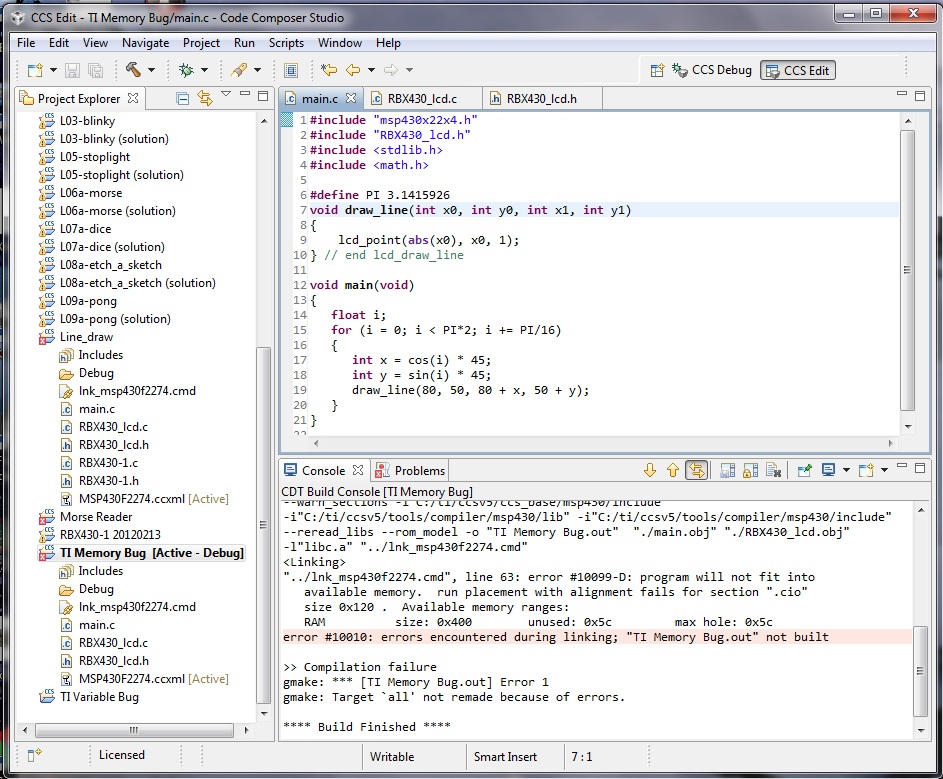

    I'm also sending you screen shots from v5.1.  Just a quick history, I'm frankly not sure of my configuration, but I've tried this on several machines.  We down loads from the TI website v51. and installed it on all our lab machines.  After installation on my machine, I discovered that I could not compile my demo program because of RAM errors.  (It complies and runs just fine under v4.0.)  I was instructed by TI to try earlier compiler tools.
    So, I installed v5 again from my CCS IDE UNIVERSITY CD w/Floating Site License.  It seems like I can't go back or forward.  You obviously have something different from me - I just don't have an advanced optimization menu.  Shouldn't there be something somewhere??
    I've taken my demo code and really isolated the problem to a small amount of code.  Here it is:
    main.c:
    #include "msp430x22x4.h"
    #include "RBX430_lcd.h"
    #include <stdlib.h>
    #include <math.h>
    #define PI 3.1415926
    void draw_line(int x0, int y0, int x1, int y1)
           lcd_point(abs(x0), x0, 1);
    } // end lcd_draw_line
    void main(void)
    float i;
    for (i = 0; i < PI*2;
    i += PI/16)
    int x = cos(i) * 45;
    int y = sin(i) * 45;
    draw_line(80, 50, 80 + x, 50 + y);
    RBX430_lcd.h:
    #ifndef
    LCD_H_
    #define LCD_H_
    typedef char int8;
    typedef int int16;
    typedef unsigned char uint8;
    typedef unsigned int uint16;
    uint8 lcd_point(int16 x, int16 y, uint8 flag);
    #endif /*LCD_H_*/
    RBX430_lcd.c:
           return 0;                                // return success
    } // end lcd_point
     Here is what I get:
  • Hi Paul,
    odd.  I took that capture directly from an installation of 5.1.09 .. the version you posted you were using.  I simply created a new CCS Project and opened a basic MSP blink the LED example.  I think went into project properties and I always get the advanced.
    I am using code generation tools version 4.0.0 which seems to have come with 5.1.09.
