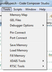

We have the latest version of CCS installed and we noticed that some tools are missing. Screenshot below.
As we start developping with Sys/bios they would be very useful. How can we get them back ?

  • We use the C6678EVM
    We are looking for the RTA  tools, ROV, Image analyser, graph, trace control, trace analyser, profile, ...
    We use bios_6_32_05_54, mcsdk_2_00_05_17, xdctools_3_23_01_43, CCS v5.1.1.00031

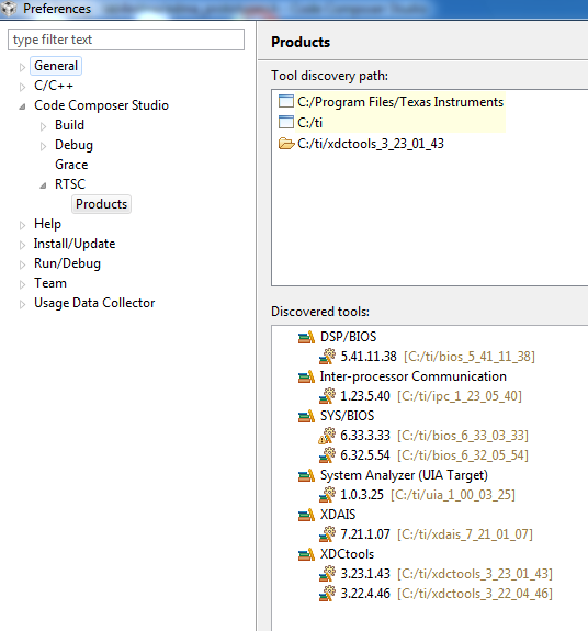

    odd, it sounds like you have all you need so I am surprised you are having problems finding it.    What emulator do you use?  What do you see under
    Window->Preferences->Code Composer Studio->Build->RTSC->Products?
    What OS are you on?  Where are the XDC, MCSDK etc installed?
    Lisa
  • Emulator XDS100v1
    screenshot of RTSC-> products
    dont pay attention to SYS/bios 6.33.3.33 we don't use it.
    We are on windows 7 32 bit
    Everything (CCS, MCSDK, XDC) is installed under C:ti

  • Hi Clement,
    ok, I wonder if actually you are encountering this know issue we had with the MCSDK not installing properly.  There were a few issues with both migration from 5.0.x and installation over 5.1.
    Please have a look at this thread and its links and let us know if that helps resolve the issue.  It could be this is what is happening.
    http://e2e.ti.com/support/development_tools/code_composer_studio/f/81/t/164155.aspx
    Lisa
  • Ok,
    my co-worker re-installed CCS 5.1 and then re-installed MCSDK without the MCSA
    and now he has the tools.
    I guess it'll work for me too.
