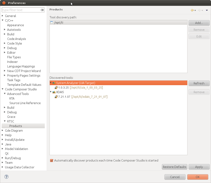

I just installed CCS v5.1.1.00033 and am trying to compile a DSP/BIOS 5.x DSP/BIOS application.
CCS claims that I don't have any versions of BIOS or XDCTOOLS installed.  However, the installation was supposed to put versions of both on when it installed.

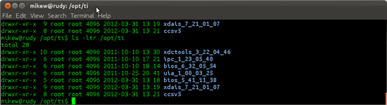

A quick check in the /opt/ti area shows that there is a BIOS version that should be discovered, but when I check preferences->RTSC->products, the discovery feature doesn't find it.
I am attaching snapshots of the listing of /opt/it as well as the preferences view.

  • HI Mike,
    did you try adding the BIOS tools manually from the Products section you sent a screen capture of?  Does that work?  Do you have full permissions?  Did you check that there is no extra directory layer?

  • Yes.  I tried to manually point the directory.  I also tried to navigate down a couple of layers as well to no avail, but the documentation for CCSV5.1 says the discovery tool should do that form me.  What layer of the directory (packages, packages/ti, packages/ti/bios) should I point to?
    What permissions are required?  I installed CCSV5.1 as root (using sudo).  These tools were installed as part of the CCSV5.1 installation process (a "complete package" install).  I sort of expected the tool to find what it installed by default...
    I can redownload and reinstall (as sudo?  as private user elsewhere?), but it would be nice if I could resolve what the problem is.  The tools that were discovered appear to have the same permissions as those that were not, and all of them were installed by the CCS installer.

  • HI Mike,
    I am still trying to sort this out in the background for you, but have you launched CCS from the terminal with sudo?  I think this might acutally simply be a linux permissions things.  I launched css ... sudo ./ccstudio from the appropriate directory from a terminal and had BIOS ....
    Do you see the same?  Is it simply running CCS as root?
    Lisa
  • If I run CCS as root (using "sudo /opt/ti/ccsv5/eclipse"), I can confirm it is able to see all the installed packages.  So this does appear to be permissions based.  Any suggestions as to a fix? (we normally don't build and install software as a root user....)
