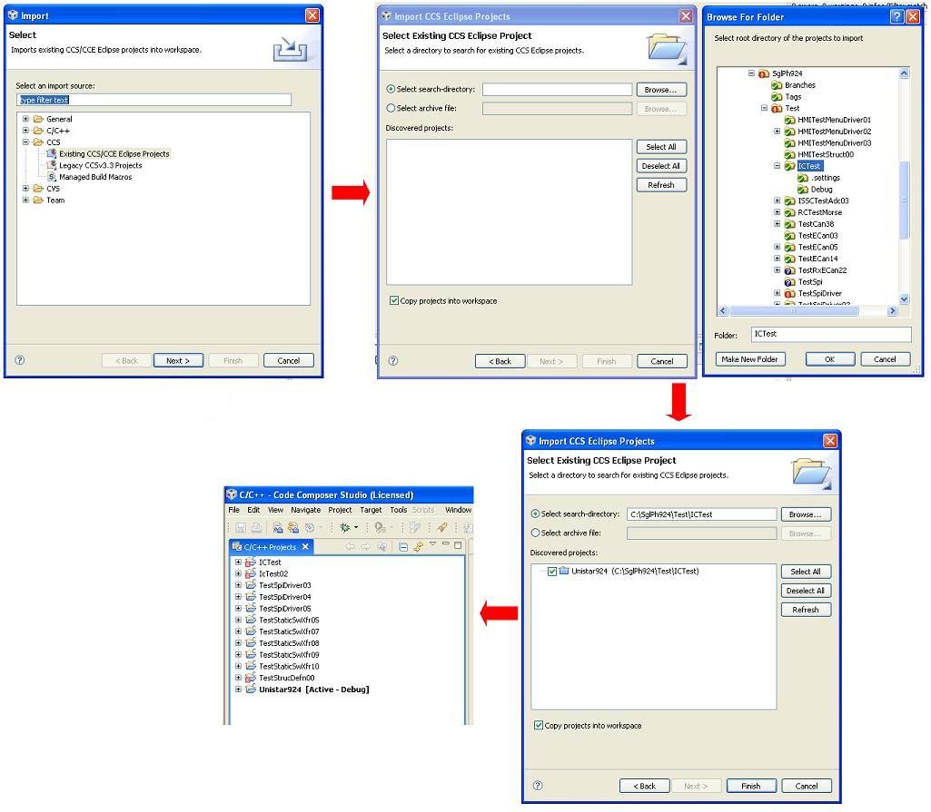

  • I had no recollection of Code Composer asking me whether I
    wanted to build with the new version, so I deleted the
    project and imported it again.  The complete wizard cycle is
    illustrated herewith:
    I still don't see anything about changing versions.

    You will recall, when someone said the import wizard should
    ask me during the import process whether I want to switch
    versions of the compiler, I deleted the project that was
    causing me pain, and re-imported the project, capturing
    every screen of the process in an image that I posted on
    this forum. I was trying to document that it never asked me
    whether I wanted to switch versions, and I didn't see it the
    second time.
