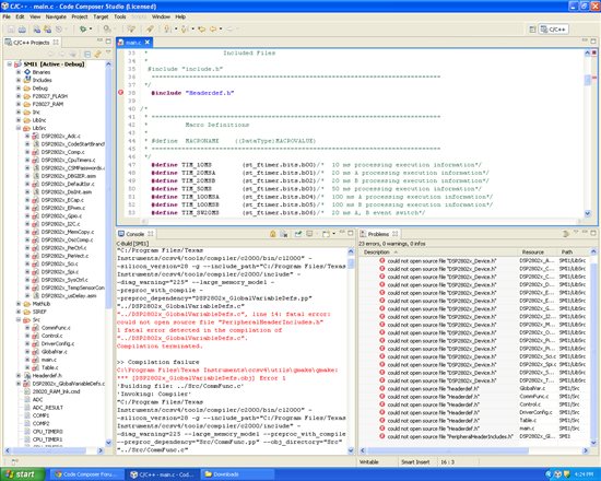

           I have this problem while building my code in ccs v4.  I am totally new to this tool. This project is bit old and my previous guy did this project and handed over to me. I have imported the project file to the tool and fine. When I go for building these errors occurs. I tried this linking files and other option, I am not getting the correct way to solve the problem , your guidance will be appreciated . Thanks in advance for the help.

  • It would appear that the import process did not grab the C Compiler include path setup from your counterpart's setup.
    The C compiler is offering an error indicating various C header files can not be opened, likely due to not being found in the directories that have been provided to the C compiler to look.  You should modify the Project Build settings to add the appropriate paths to the C header files for the C compiler.

  • Perhaps you new build log would help illustrate the effects of the changes you have made.  This would help to see if we are on track.
    I may not have been clear in terms of what I mean when suggesting to add the include path to the build options.  You need to select the menu Project->Properties option.  This will invoke a dialog box that allows you to select the C compiler build options.  There should be a category indicating "Include Options".  You would then add the directory appropriate for the expected relative path for the header file.

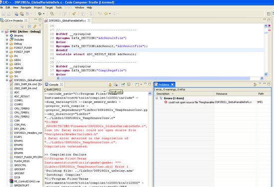

    I have added the header files through this path project > properties> c/c++ build options. After doing some trail and error method I have end up with one error at last as the screenshot I have attached. Please give you’re valuable guidance. Look forward to hear back form you.
    The error is like this
    could not open source file "PeripheralHeaderIncludes.h" SMI1 DSP2802x_GlobalVariableDefs.c line 14 1334741507836 26
    Thanks and regards
    Anand
  • Is there a PeripheralHeaderIncludes.h file somewhere on your hard drive?
    You mentioned in your original post that this code base was somewhat dated.  That is certainly true since more recent releases of the device support files for the TMS320F2802x do not have this file name used in the DSP2802x_GlobalVariableDefs.c file.
    My suggestion, flying blind here, is for you to identify where this requested file is on your PC's hard drive and add the path to this file in the C compiler include path switches like before.

    Thanks for all your help . The compiling issues got solved.
