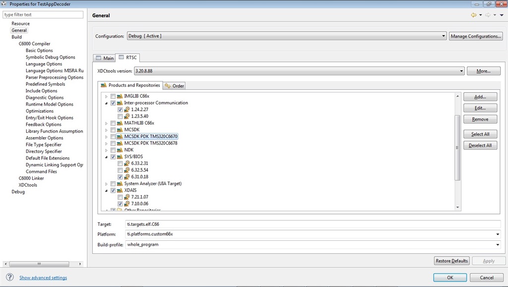

    My current RTSC configuration for this project is, with XDCtools 3.20.8.88:
    Can anyone from texas instruments please help? I'm struggling to make this damned demo project work.

  • I've solved the last problem.
    It was caused by the newer ipc version. Just using a older onde, solved it.
    Now the project compiles and link without  problems.
