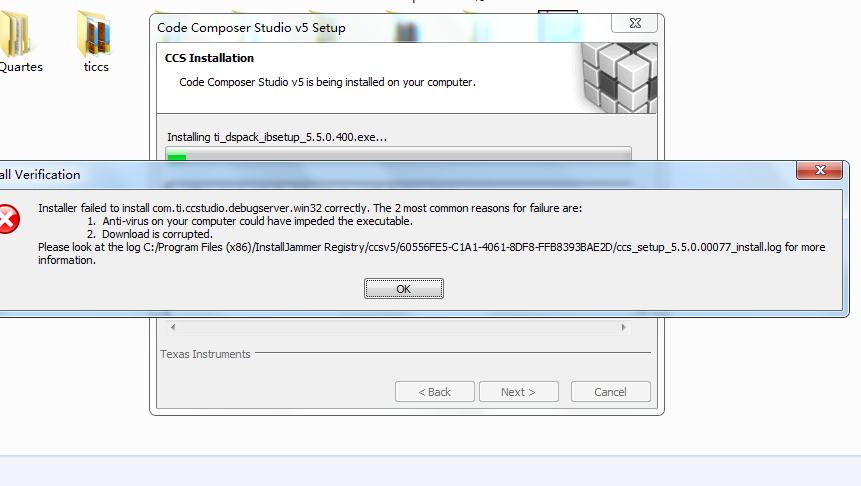

  •  I encounter the same mistake at installing ccsv5.4.  And here is a picture when I double click the ccs_setup_5.4.0.00091.exe which is the mistake. Then I click ok but still install failed at debugserver .I find  the com.ti.ccstudio.debugserver.win32_root_5.4.0.279.I install this software for msp430f5529 launchpad.
