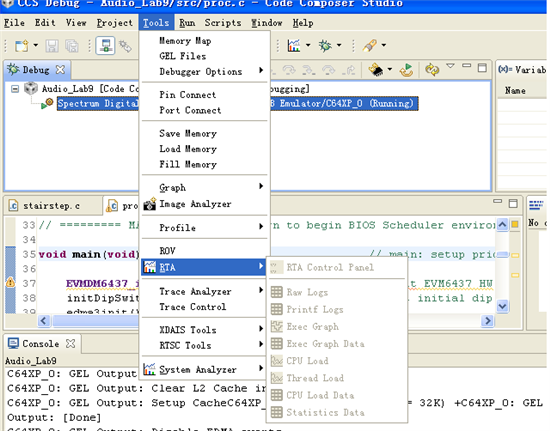

Hello,everyone.
I creat a new project based on BIOS bios_5_41_11_38. However when I used RTA tools,they are gray,I can not click.
I want to see the CPULoad.But I do not know why. (I have enable the RTA)
Thank you for your help.
Junqing
Hello,everyone.
Junqing
Junqing,
Not sure if you've been able to resolve this issue. If not can you post me you .cfg file. If you prefer, you can email me iali@ti.com.
Also can you check if other items in the Tools menu (e.g. Graph is greyed out also).
Imtaz.
