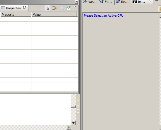

  • Oliver,
    It looks suspicious that the error is associated with CCS’s CPU connection. After relaunching CCS, although the CPU is connected and both program and data can be loaded onto that, the Image Analyzer would show “please select an active CPU” message, seems suggesting the same thing as the “Error: no device connected” message.

  • Noah,
    Thanks. I think I have seen enough information and don’t need your workspace. We have identified an issue that could be causing the problems you’re seeing. Please check if the folder .metadata\.plugins\com.ti.dvt.graph.visualization\savedSolutions exists in your workspace and has files in it. If it has, please exit CCS, delete the folder and re-start CCS. This should get rid of the problem.
    We found that the workspace can get into this bad state if Graph views (not Image Analyzer views) are closed during CCS startup while they still haven’t been fully restored. Until there’s a fix for this issue you can prevent this problem from reoccurring if you wait until all Graph views have finished drawing themselves completely, i.e. show the axes and labeling, before closing them.
    Please let me know if this solved your problem.
    Oliver
