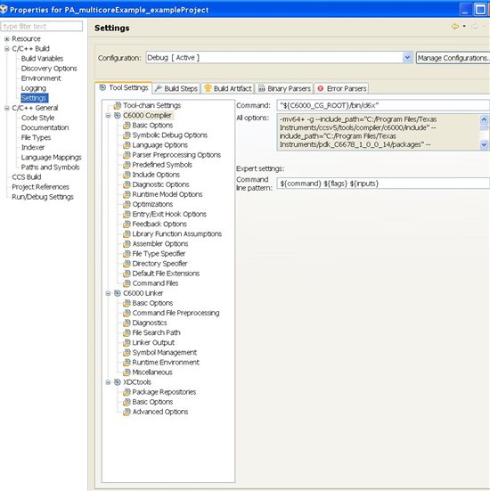

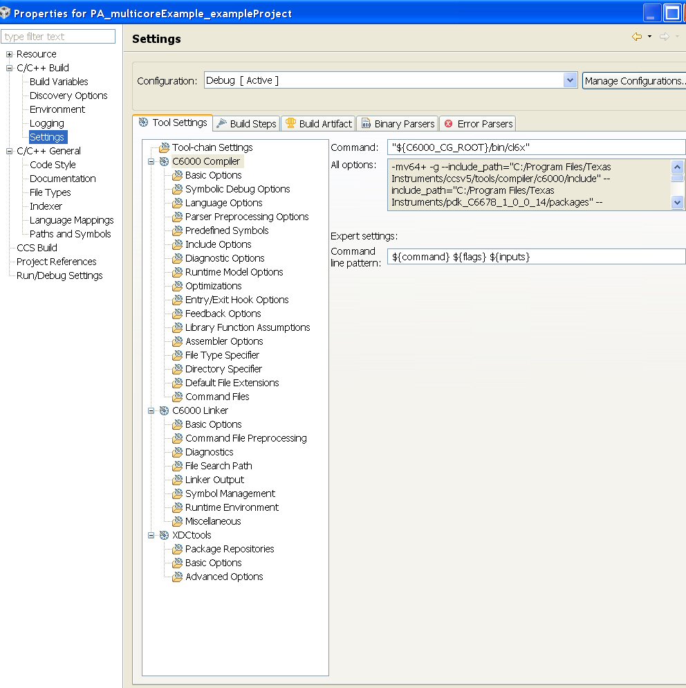

  • Lisa,
    I think the problem is the view I see under properties differs from those shown in the wiki pages you talk about. So I am not able to make probably the appropriate changes.
    Here is mine with the settings highlighted.
    Aamir
    I believe the issue is something to do with the macro.ini files in the project directory in the workspace that I am using.
