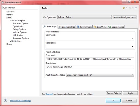

I know how to get a .hex from CCS4 IDE. But now that I have updated to CCS5, I don't see how to do it anymore.
Thanks in advance

    what target are you using?   Have you tried Project->Properties->Build- and then in the "Build Steps" tab see "Apply Predefined Steps"

    Thanks for the quick reply. The target device is MSP430F2471. The steps you mentioned are what I used to do in CCS4. In version 5 of CCS, however, "Build Steps" is not listed anywhere I could find in project properties.

    what exact CCS version and compiler version do you have?  The compiler version can be checked under Window->Preferences->Code COmposer Studio->Build->Code Generation Tools.
    Can you send a screenshot?
    I just tried in 5.1.1 and have no issues finding this tab or option.  Please see my screeshot.
    Lisa
  • Ops,
    The only thing I forgot to do was to actually click on the "Build" text. I just kept on clicking the "-" sign to expand it. I must appologize for this mistake.
    Thanks a lot Lisa. I appreciate your quick response. I will mark your reply as "answered the question".
