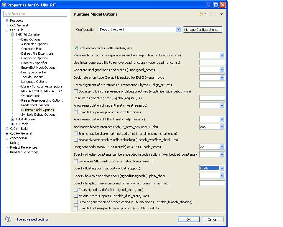

    So I started looking at the settings I have and I saw that I was picking a particulate Floating Point Library.  I changed it so that nothing was selected and not it seems to work.
    So that brings up the question of, where is the documentation for the different Floating Point Librarys are so that we know what to choose?
    Here is the screen I am talking about with the library that failed.  When I select nothing (or get the window blank) we seem to work.
    So what does that mean?
    Thanks!

  • That seems inconsistent between double and float... Could you please post the exact command line options you are using to compile with?  It might also help to see the linker map file.
    Please see the section titled VFP Support in the ARM compiler manual.
    Thanks and regards,
    -George
  • According to the documentation the fpalib uses Big Endianness  which is what we were seeing.  Also indicates that it is for ARM11 and above we are on an OMAPL138 which is a ARM9.
    This takes care of the issue.
