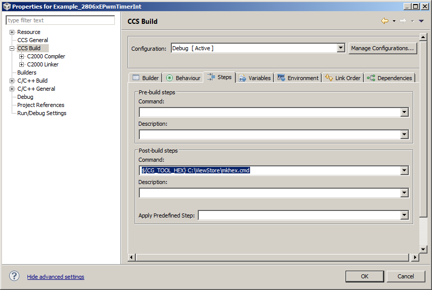

I am using a TMS320F28335. The command line I use is:
cd \path\to\DummyApp\Debug
\path\to\hex2000.exe \path\to\mkhex.cmd
The content of mkhex.cmd can be found at this end of this post.
