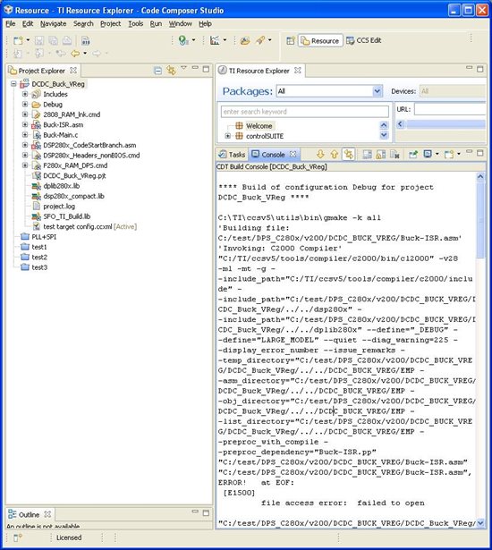

    From following console msg (with red color), it seems the compiler can not open the Buck-ISR.asm. I am not able to figure out in the Linked Resources" tab, where I should change to have corect path. Any clue?

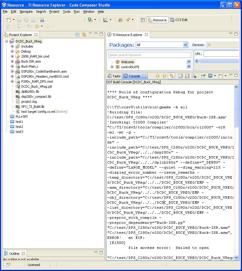

    **** Build of configuration Debug for project DCDC_Buck_VReg ****
    C:\TI\ccsv5\utils\bin\gmake -k all
    'Building file: C:/test/DPS_C280x/v200/DCDC_BUCK_VREG/Buck-ISR.asm'
    'Invoking: C2000 Compiler'
    "C:/TI/ccsv5/tools/compiler/c2000/bin/cl2000" -v28 -ml -mt -g --include_path="C:/TI/ccsv5/tools/compiler/c2000/include" --include_path="/packages/ti/xdais" --include_path="C:/test/DPS_C280x/v200/DCDC_BUCK_VREG/DCDC_Buck_VReg/../../dsp280x" --include_path="C:/test/DPS_C280x/v200/DCDC_BUCK_VREG/DCDC_Buck_VReg/../../dplib280x" --define="_DEBUG" --define="LARGE_MODEL" --quiet --display_error_number --issue_remarks --temp_directory="C:/test/DPS_C280x/v200/DCDC_BUCK_VREG/DCDC_Buck_VReg/../../DCDC_BUCK_VREG/EMP --asm_directory="C:/test/DPS_C280x/v200/DCDC_BUCK_VREG/DCDC_Buck_VReg/../../DCDC_BUCK_VREG/EMP --obj_directory="C:/test/DPS_C280x/v200/DCDC_BUCK_VREG/DCDC_Buck_VReg/../../DCDC_BUCK_VREG/EMP --list_directory="C:/test/DPS_C280x/v200/DCDC_BUCK_VREG/DCDC_Buck_VReg/../../DCDC_BUCK_VREG/EMP --preproc_with_compile --preproc_dependency="Buck-ISR.pp" "C:/test/DPS_C280x/v200/DCDC_BUCK_VREG/Buck-ISR.asm"
    "C:/test/DPS_C280x/v200/DCDC_BUCK_VREG/Buck-ISR.asm", ERROR! at EOF:
    >> Compilation failure
    'Building file: C:/test/DPS_C280x/v200/DCDC_BUCK_VREG/Buck-Main.c'
    [E1500]
    file access error: failed to open
    --list_directory=C:/test/DPS_C280x/v200/DCDC_BUCK_VREG/DCDC_Buck_VReg/../../DCDC_BUCK_VREG/EMP/Buck-ISR.obj"
    for writing
    "C:/test/DPS_C280x/v200/DCDC_BUCK_VREG/Buck-ISR.asm", ERROR! : [E1000]
    Failed to write object file :
    gmake: *** [C:/test/DPS_C280x/v200/DCDC_BUCK_VREG/EMPBuck-ISR.obj] Error 1
    "C:/TI/ccsv5/tools/compiler/c2000/bin/cl2000" -v28 -ml -mt -g --include_path="C:/TI/ccsv5/tools/compiler/c2000/include" --include_path="/packages/ti/xdais" --include_path="C:/test/DPS_C280x/v200/DCDC_BUCK_VREG/DCDC_Buck_VReg/../../dsp280x" --include_path="C:/test/DPS_C280x/v200/DCDC_BUCK_VREG/DCDC_Buck_VReg/../../dplib280x" --define="_DEBUG" --define="LARGE_MODEL" --quiet --display_error_number --issue_remarks --temp_directory="C:/test/DPS_C280x/v200/DCDC_BUCK_VREG/DCDC_Buck_VReg/../../DCDC_BUCK_VREG/EMP --asm_directory="C:/test/DPS_C280x/v200/DCDC_BUCK_VREG/DCDC_Buck_VReg/../../DCDC_BUCK_VREG/EMP --obj_directory="C:/test/DPS_C280x/v200/DCDC_BUCK_VREG/DCDC_Buck_VReg/../../DCDC_BUCK_VREG/EMP --list_directory="C:/test/DPS_C280x/v200/DCDC_BUCK_VREG/DCDC_Buck_VReg/../../DCDC_BUCK_VREG/EMP --preproc_with_compile --preproc_dependency="Buck-Main.pp" "C:/test/DPS_C280x/v200/DCDC_BUCK_VREG/Buck-Main.c"
    Command-line error #569: cannot open IL output file C:/test/DPS_C280x/v200/DCDC_BUCK_VREG/DCDC_Buck_VReg/../../DCDC_BUCK_VREG/EMP --asm_directory=C:/test/DPS_C280x/v200/DCDC_BUCK_VREG/DCDC_Buck_VReg/../../DCDC_BUCK_VREG/EMP/Buck-Main.if - Invalid argument
    1 fatal error detected in the compilation of "C:/test/DPS_C280x/v200/DCDC_BUCK_VREG/Buck-Main.c".
    Compilation terminated.

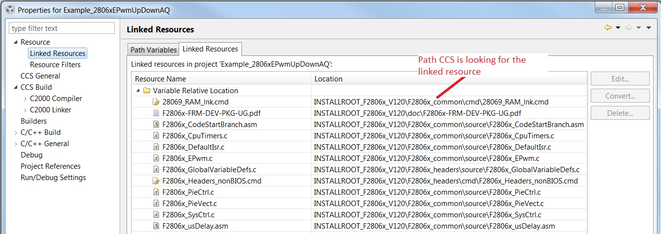

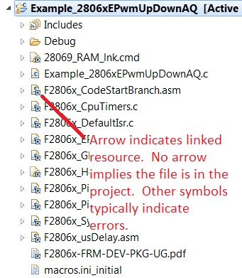

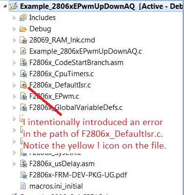

    To begin with, take a look at this example project.  You'll notice all of the files which have the arrow in the lower right corner of the file icon are linked resources.  These are the ones we need to make sure are resolving.

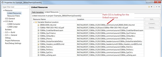

    So now right click on the project name, in this case, Example_2806xEPwmUpDownAQ, and select properties.  Next, expand the Resource option on the top left and highlight Linked Resources.  Now on the right hand side, select the Linked Resources tab.  This will show all of the linked resources for your project.  In this case, they are all being resolved properly, but if any weren't they would be on the top with a red x next to them.
    So now I'll modify one of the paths so that the file is not properly resolved.  As you can see, CCS is telling us that it cannot find the F2806x_DefaultIsr.c file by putting the yellow ! icon on the file.

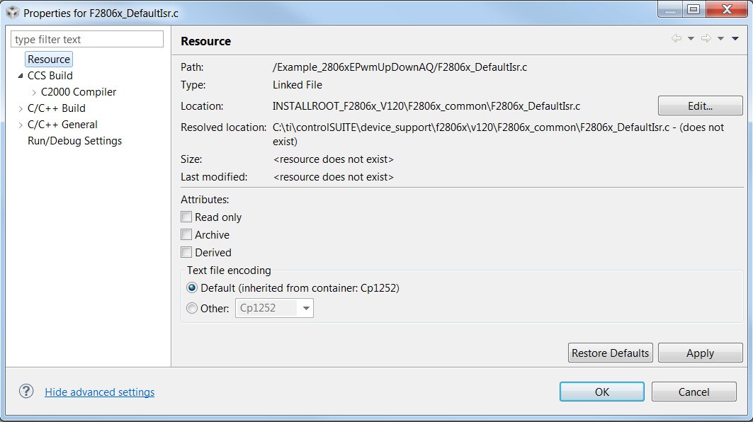

    So now let's right click on F2806x_DefaultIsr.c and select properties.  This window here is very useful in the debug.  Let's pay particular attention to the "Location" and "Resolved Location" fields.  The "Location" is the path that we have given CCS to look for the file.  This path is using the INSTALLROOT_F2806x_V120 variable, so the Resolved Location gives us the actual full path CCS resolved the "Location" field to on our machine.  Now we can go find the file on our machine and compare the full path to the Resolved Location and see what isn't adding up.  In this case, the file actually exists at C:\ti\controlSUITE\device_support\f2806x\v120\F2806x_common\source\F2806x_DefaultIsr.c.  So by comparing this path with the Resolved Location, you will see I removed the source directory from the CCS Location path.
    What may have happened is the variable, in this case, INSTALLROOT_F2806x_V120 may be going up a certain number of directories, and for whatever reason is now going up an extra directory or not going back far enough.  If this is the case, you can modify the path by going back to my first image and highlighting the Path Variables tab.

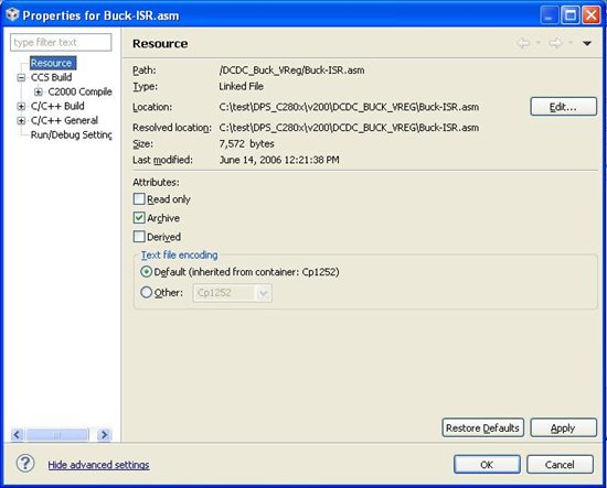

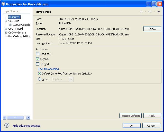

  • Hi Kris,
    Thanks for the guide info.
    I am still using SPRC229 from Ti as example (you can download it from: http://www.ti.com/mcu/docs/mcuorphan.tsp?contentId=50550)

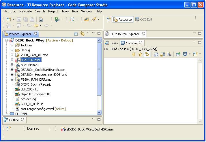

    The first file failed at compilation is with Buck_ISR.asm. From following, this file in the Project Explorer is without the yellow ! icon as in your screen, but with red X icon. From following screen, you also can see the error message after compilation. I also attach the Buck_ISR.asm's property screen and project folder screen as following.

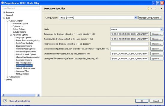

  • Mark,

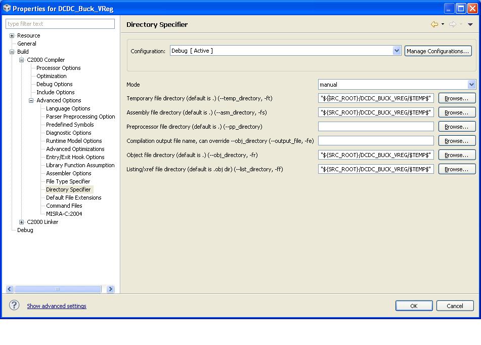

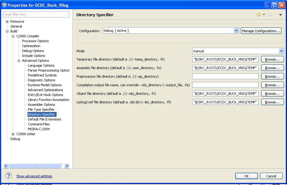

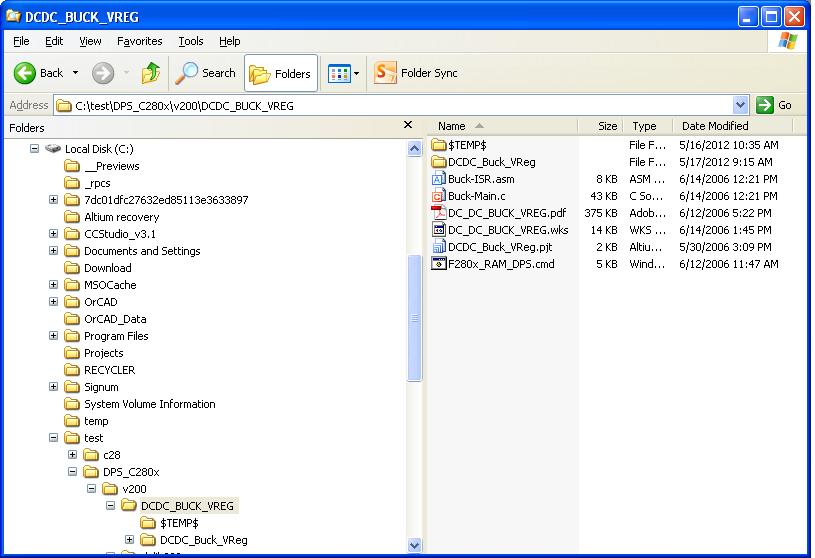

    If you open the original CCS 3.3 .pjt you will see the following:  -fr".\$TEMP$" -fs".\$TEMP$" and so on. These options set the directory to place files generated by the compiler such as obj files, asm files and so on.
    When migrated to CCSv5, these options look like this on the command line you see in the build console:
    As you can see the $TEMP$ is not getting processed properly and then CCS is having trouble resolving these options properly.
    If you change these options to set the directory say to C:/test/DPS_C280x/v200/DCDC_BUCK_VREG/DCDC_Buck_VReg/../../DCDC_BUCK_VREG/TEMP it should build fine. I just verified that it does. To do this, in CCSv5, go into Project Properties->CCS Build->C2000 Compiler->Directory Specifier, and change the directory settings for -ft, -fs, -fr and -ff to something other than $TEMP$. I simply changed it to TEMP and that helped.
    Let us know how this goes.

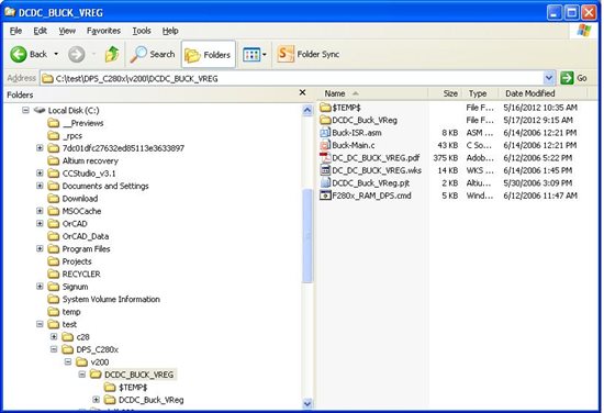

  • Hi ,

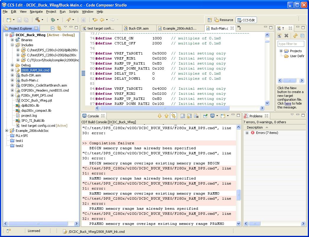

    By following your suggestion, after the building, The red X icon on both Buck_ISR.asm and Buck_Main.c are gone. That is a good news.

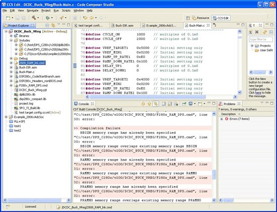

    But I still see link errors (see below). The compile output report with red color attached below too.
    Do you think because of the 2808_RAM_Lnk.cmd file? Should I need the file F280x_RAM_DPS.cmd only?
    Please advise.
    By the way, why there is no any project code as example in the ControlSuite for 280x chip? Those chip are not good for new design?
    To answer Lisa's question, I haven't use CCS v4.
    Is any project code as example available for CCS v4?
    Appreciate all of your efforts!
    Mark

    "C:/test/DPS_C280x/v200/DCDC_BUCK_VREG/F280x_RAM_DPS.cmd", line 30: error:
    >> Compilation failure
    BEGIN memory range has already been specified
    BEGIN memory range overlaps existing memory range BEGIN
    "C:/test/DPS_C280x/v200/DCDC_BUCK_VREG/F280x_RAM_DPS.cmd", line 31: error:
    RAMM0 memory range has already been specified
    RAMM0 memory range overlaps existing memory range RAMM0
    "C:/test/DPS_C280x/v200/DCDC_BUCK_VREG/F280x_RAM_DPS.cmd", line 32: error:
    PRAMH0 memory range has already been specified
    PRAMH0 memory range overlaps existing memory range PRAMH0
    "C:/test/DPS_C280x/v200/DCDC_BUCK_VREG/F280x_RAM_DPS.cmd", line 33: error:
    RESET memory range has already been specified
    RESET memory range overlaps existing memory range RESET
    "C:/test/DPS_C280x/v200/DCDC_BUCK_VREG/F280x_RAM_DPS.cmd", line 34: error:
    BOOTROM memory range has already been specified
    BOOTROM memory range overlaps existing memory range BOOTROM
    "C:/test/DPS_C280x/v200/DCDC_BUCK_VREG/F280x_RAM_DPS.cmd", line 41: error:
    RAMM1 memory range overlaps existing memory range BOOT_RSVD
    RAMM1 memory range has already been specified
    RAMM1 memory range overlaps existing memory range RAMM1
    "C:/test/DPS_C280x/v200/DCDC_BUCK_VREG/F280x_RAM_DPS.cmd", line 42: error:
    DRAMH0 memory range has already been specified
    DRAMH0 memory range overlaps existing memory range DRAMH0
    error #10010: errors encountered during linking;
    "C:/test/DPS_C280x/v200/DCDC_BUCK_VREG/DCDC_Buck_VReg/../../DCDC_BUCK_VREG/D
    CDC_Buck.out" not built
    gmake: *** [C:/test/DPS_C280x/v200/DCDC_BUCK_VREG/DCDC_Buck_VReg/../../DCDC_BUCK_VREG/DCDC_Buck.out] Error 1
    gmake: Target `all' not remade because of errors.
    **** Build Finished ****
    Most likely. Those linker errors are common ones for v3 BIOS projects imported into v5. That is because in v5, it will often try to auto-pull in another cmd file hence you have two cmd files in there that define the same memory sections. Or it could be that one of the cmd files pulls in a another via the -l option which is no longer needed (see figure 8 of: http://processors.wiki.ti.com/index.php/Importing_CCSv3_Projects_into_CCSv4)
    ki
  • Ki is right. The 2808_RAM_lnk.cmd which I see in your screenshot does not need to be part of the project. The presence of two linker command files is causing conflicting MEMORY definitions. Delete that file or exclude it from build (by right-clicking and selecting Resource Configurations->Exclude from Build) and rebuild.
