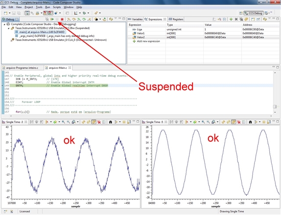

I’m facing a strange problem using the Graph of CCS v5.
1- When the code is running, the graph shows a wrong waveform:
2- When I click suspend, the graph shows a correct waveform:
Obs: Is the same code, the only difference is the figure 1 is running the code, and figure 2 the code was suspended.

    Since real-time mode and auto-refresh is enabled, for part 1, the graph should be constantly updating while in part 2, it would not be (unless you enabled interrupts to be handled while halted and the graph data is dependent on that).

  • The real-time data in the buffer is being updated while the graphing function is accessing it.  Therefore, the graph shows data segents from several different bufferloads.
