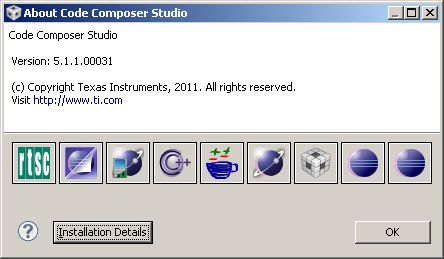

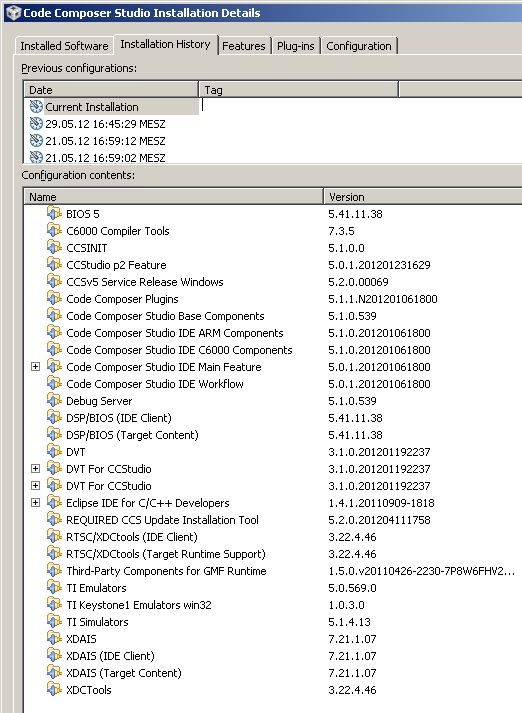

  • Hi Lisa,
    I have noticed the same behaviour, unfortunately I did not take a screenshot of the 'unable to connect to xyz' message. What I did:
    - I had CCS 5.1.1 installed.
    - CCS 5.2.0.00069 is reported available at 'check for updates'
    - a few seconds after installation start (too less to download a ccs installer...), a CCS restart is requested
    - then after a few seconds, a popup message 'unable to connect to .... please check later' appears
    - after a restart of CCS, a new 'check for updates' reports CCS being 'up to date'
    Installation details shows a "CCSv5 Service Release Windows" 5.2.0.00069 being installed. But CCS itself is still reported to be V5.1.1:
    bye,
    Thomas

  • Thomas9070,
    My working theory as to what has happened in your case goes as follows:
    The search for updates found a bunch of possible components. You accepted the updates and part of the update content was downloaded. Not all the update content is downloaded before Eclipse requests you to restart. If the initial update download is successful, the feature list is updated to reflect the new versions. Eclipse then asks you to restart.
    After the restart, additional installation steps are run that cannot be completed while Eclipse is running. One of these steps requires  additional content be downloaded. This download step has failed. Perhaps it was unable to resolve the required network address. The point where the failure occurred did not roll-back the feature version displayed in eclipse to properly reflect what is installed.
    When eclipse starts after the failure, it appears that all the features are up to date even though not everything has been updated.
    We can retry this update by itself as follows
    * Download the web installer from the CCS download page.
    * Run the web installer and give it the CCS 5.1.1 install folder as the installation location.
    If download problems persist, you can also download the full ccs install package as a zip file. If you run the installer from this package and give it the 5.1.1 install folder as the destination, it will update the 5.1.1 install to 5.2.0.
    If you are seeing download problems when using the web installer, I would like to see if there is more data I can get from you. As the initial eclipse portion succeeds, there must be something different about how the installer is resolving network addresses vs what eclipse is doing.
