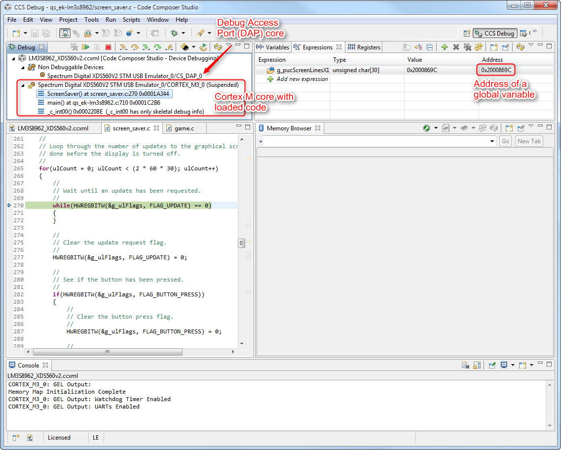

    I just confirmed that real-time memory works by connecting XDS-class emulators to the Debug Access Port (DAP).
    - Launch the debugger normally; it will connect to the M3 core, load the code and halt on main() or somewhere else depending on your configurations.
    - Find the address of a global variable that you need to monitor (local variables would be a bit more difficult as they may be placed in registers). Write the address somewhere.
    - Right-click on the Debug view and select Show All Cores. An additional core named CS_DAP_0 will be shown.
    - Right-click on the core and select Connect Target
    - Put the application to run and highlight the DAP core.
    - Open a Memory Browser and type the address of the global variable (the variable name is meaningless for the DAP core).
    - Click on the button continuous refresh. The value of the variable or even other memory addresses should change at regular intervals.
    The procedure above will eventually become a wiki page, but I just wanted to confirm the procedure was valid...
