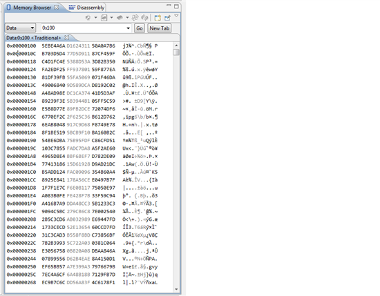

With CCS5.12 installed on top of Eclipse/Indigo as plug-in, Memory Browser shows only a half of 16-bit value.
For instance, address 0x0100 has data 0x1234, and 0x0101 has data 0xABCD.  In this case, these two are combined only by taking 8-bit, and shows value at address 0x0100 being 0x34CD.
Any special setup to make the memory browser aware that the addressing is 16-bit base?
Saving memory snapshot to *.dat file works fine, as expected.   Also disassembler window works OK.  Only Memory Browser UI is strange.
I'm using standard GEL file for F28335 from installation.
Any advise is highly appreciated.

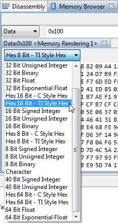

  • Nomura-san,
    There should be a drop-down menu in the Memory view where you can change the addressing format. Is it properly set to 16-bit?
    ki
  • How come this happen. .. I don't have the pull-down menu, as you see below.

  • Hi HIroshi,
    You are using the Traditional memory rendering, which is the default for existing eclipse install (CCS plugin mode). This is the standard CDT memory rendering and does not have the datatype selection that Ki mentioned. You can switch to use TI memory rendering within the Memory browser window. Select the little triangle drop down at the top right of the Memory browser view and then 'Default Rendering | Memory Rendering'. Now open a new tab, you should be able to see the datatype selection drop down list.
    Patrick
  • Patrick,
    Thank you very much.  I did not notice the "New Tab" was the key!.  I placed with the little triangle, but did not pressed New Tab button.
    Now it works fine both on my primary and 2ndary PC.
