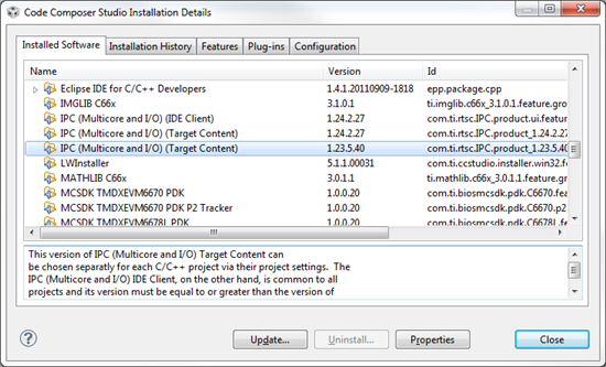

I would like to clean up my CCS 5.1 installation a bit. Therefore I tried to uninstall the IPC that came with CCS (1.23.5.40). I successfully uninstalled "C6000 IPC" and "IPC", but uninstalling "IPC (Multicore and I/O (Target Content)" is not possible because the "Uninstall..." button is grayed out.
Any ideas?

  • Hi Lisa,
    I don't want to uninstall the full CCS. I just want to uninstall older versions of certain components.
    As you can see in the screeshot below the "Uninstall..." button is greyed out, but I would like to uninstall this package.
    Do you know how to achieve this?

  • Hi Lisa,
    in Add or Remove Programs only the manually installed IPC package is visible. The one that came with CCS is not listed there.
    Kind regards, Mario

  • Hi Lisa,
    the other two entries are from a different version and I want to keep them. I want to delete it because I don't need multiple versions of IPC. No, I havent deleted the folder yet, because I think deleting it from CCS is cleaner.

  • HI Mario,
    I am not sure what further help I can be as I confirmed you should only get the uninstall on the top level IPC entry.  Have you tried under Window->Preferences->Code Composer Studio->Build->RTSC->Products?    IPC should also show up there and it is another place to manage its installation.
