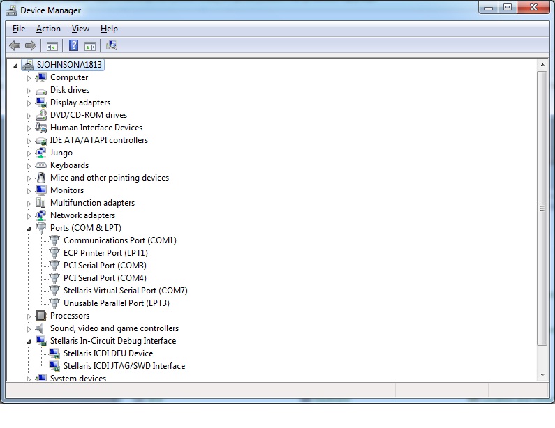

  • How would device manager issues present themselves?
    Susie
  • Hi Susie,
    if there was an issue related to driver installation you might see an unknown device or a device with a yellow exclamation mark.  If you would like, post a screenshot.
    Lisa
  • They seem to be fine.

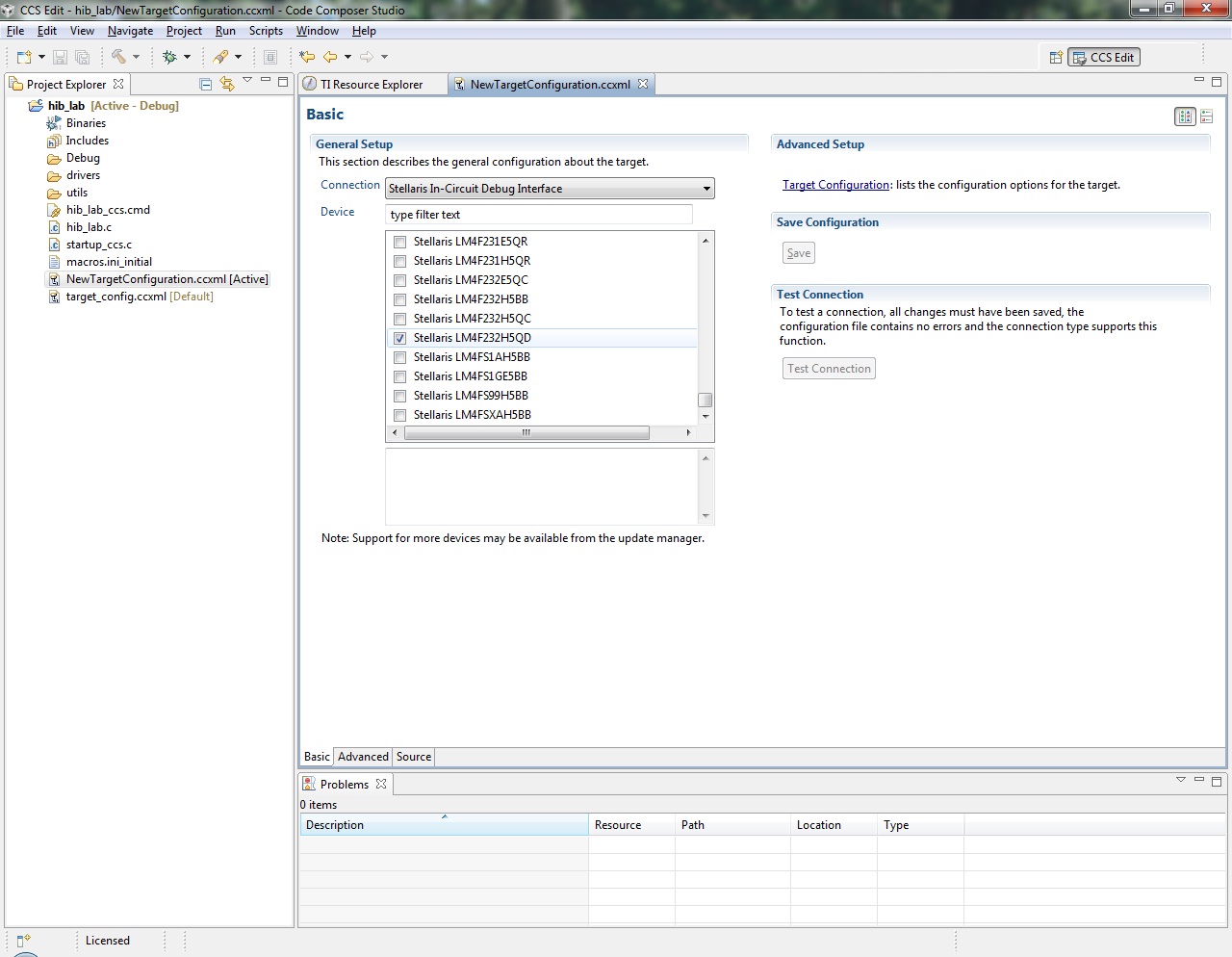

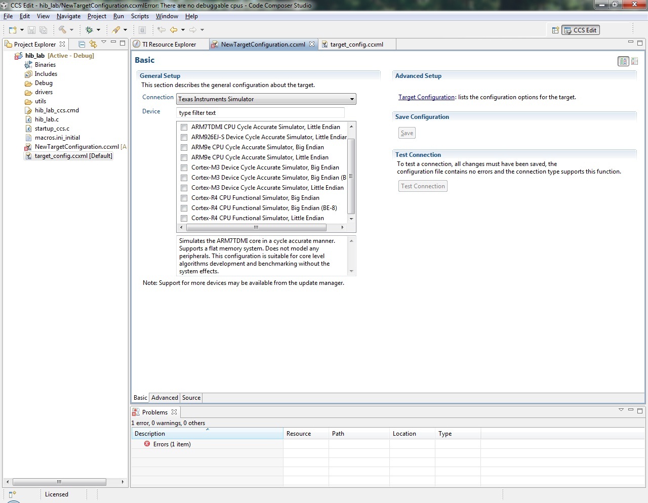

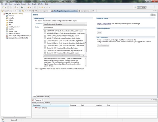

  • When creating the new target configuration file, I do not have a choice for a Cortex-M4 Device.  Please see screenshot below:
    Should Cortex-M4 Device be on the list?
  • Please disregard the last post.  I had the wrong connection chosen.
  • Now I have the new configuration file correct for the evaluation board I have (LM4F232H5QD) and the Stellaris In-Circuit Debug Interface.  See below:
    The Test Connection button is grayed out.  Is this an illegal selection?
