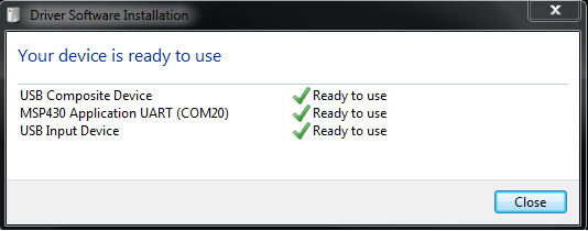

  • Just wanted to add a couple of things.
    When the Launchpad is initially plugged in and Windows installs the driver, you should see a dialog like:
    After the drivers are installed, you should two these entries in thew Windows Device Manager (in addition to other devices you may have). Under HID:
    And under Ports:

    Now to my problem. I switched off the antivirus and reinstalled to no avail. Then I realized that in the device manager MSP430 only appears under Ports, not under USB ( I did not check, that "USB Input Device belongs to TI". I finally verified with a terminal emulator, that the problem ist NOT the USB driver.
    Finally I had a look at the hardware-- CCS was right all along, it could not connect because of a hardware problem!  Fixed this and now everything works as it should.
