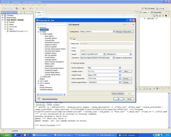

    I have exactly the same issue.  Just updated CCS and my project do not compile anymore.  I've also tried to create a new project (for a C6713 device) using the wizard and it giveq the same compliation error:
    **** Build of configuration Debug for project Test ****
    C:\Program Files\TI\ccsv5\utils\bin\gmake -k all
    'Building file: ../main.c'
    'Invoking: C6000 Compiler'
    "" -mv6700 -g --define=c6713 --include_path="C:/Program Files/TI/ccsv5/tools/compiler/c6000/include" --display_error_number --diag_warning=225 --preproc_with_compile --preproc_dependency="main.pp"  "../main.c"
    '""' is not recognized as an internal or external command,
    operable program or batch file.
    gmake: *** [main.obj] Error 1
    gmake: Target `all' not remade because of errors.
    **** Build Finished ****
    So "" instead of the complete path to the compiler.
    The variable ${CG_TOOL_CL} can't be seen in the project property when the "Show system variables" checkbox is enabled.
    Any help would be appreiciated !
    Renaud

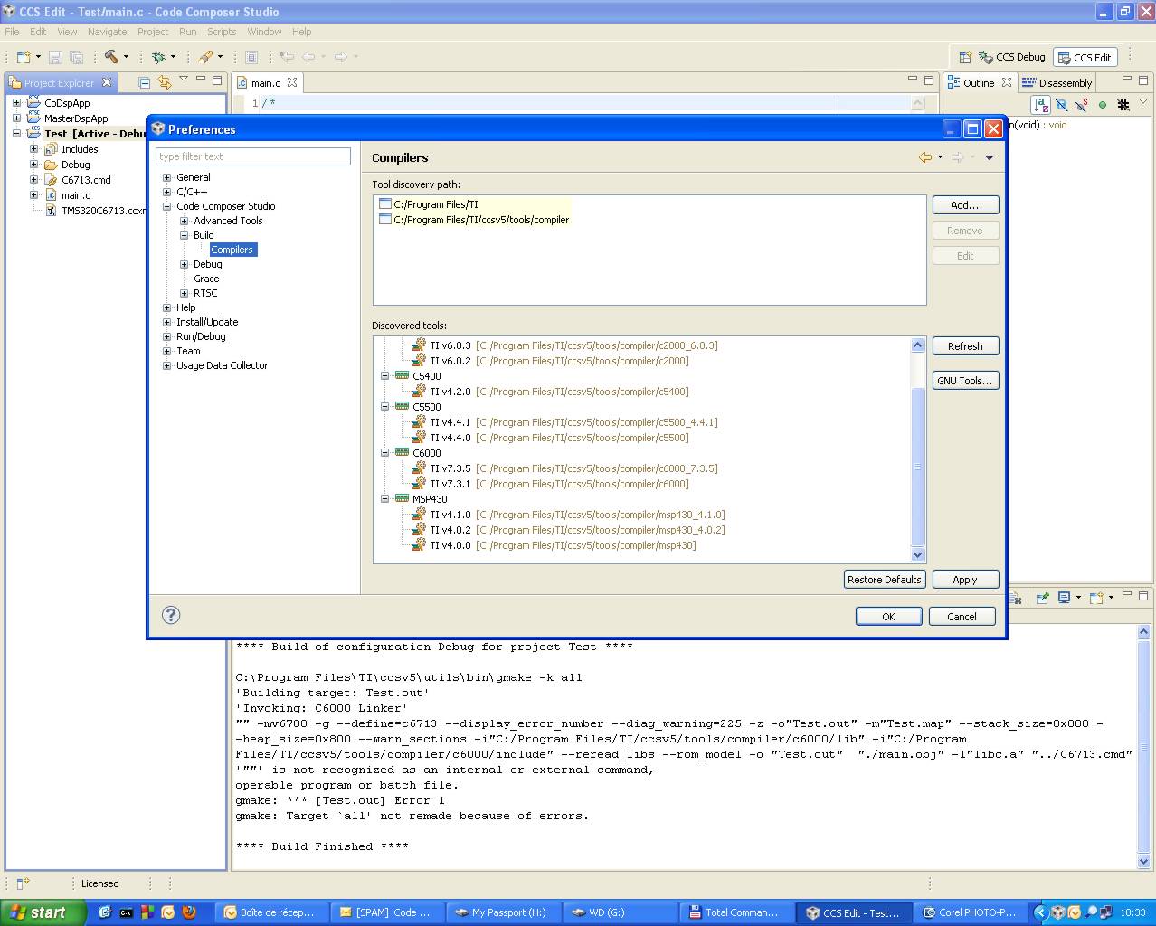

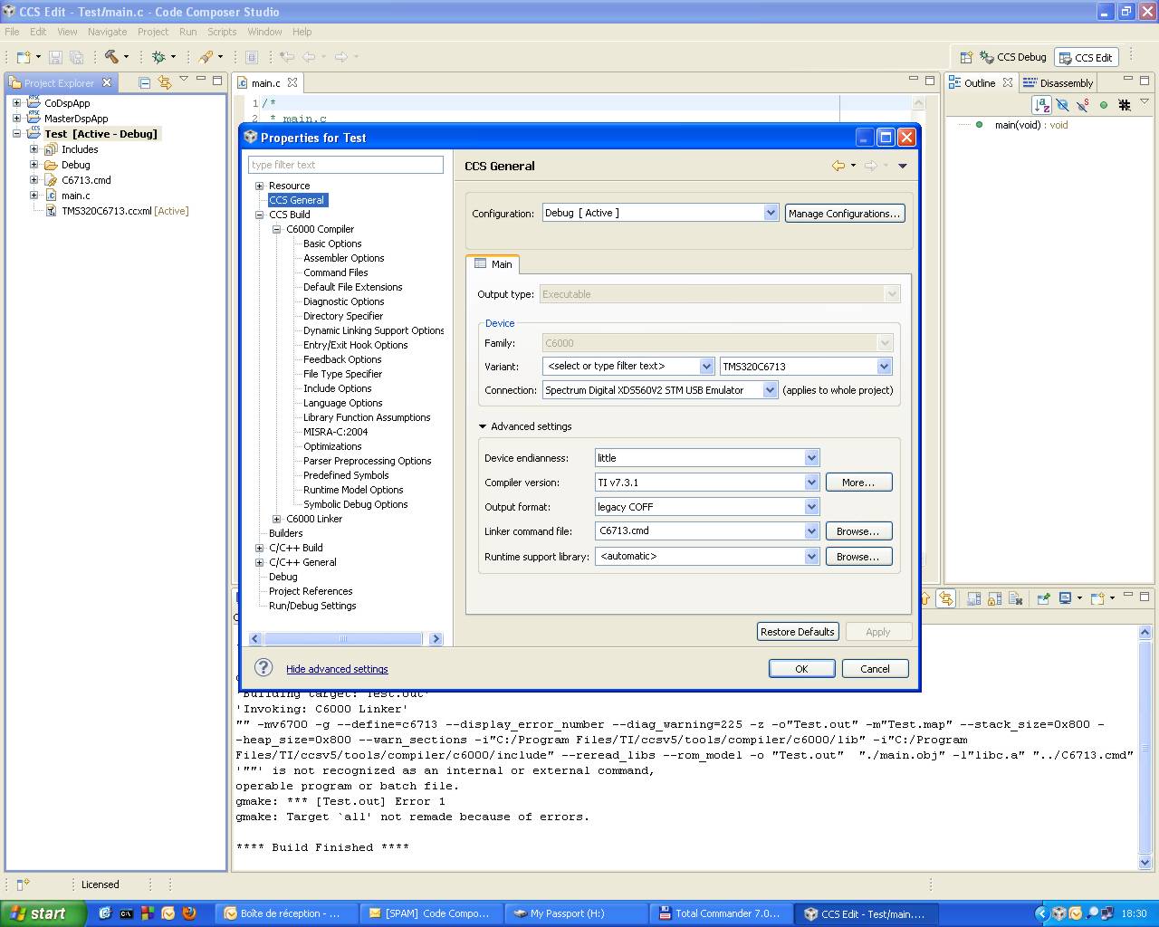

    Could you also post the screenshots of the Properties > General page for your projects, and also the Preferences > CCS > Build > Compilers page.
    - Baltasar

  • Can you let me know what was your original version of CCS, before you've updated?
    - Baltasar
  • I don't know the exact version that I was using, but I fetched it and installed it on 1/26/12.

  • I've checked the system variables, and CG_TOOLS_CL is definitely missing.  I have also noticed that the CG_TOOLS_ROOT is indicating the c6000 compiler that I originally installed and not the 7.3.5 version that was added by the upgrade.  Am I supposed to maintain these system variables manually?  Is there some other way to select the compiler to use?
  • No, the user is not expected to manually maintain these variables.  They should automatically point to the location of the compiler selected by the user in the Properties > General page.  Something must have corrupted your installation of CCS, possibly during your recent update - your log file shows many issues with classloading.  I will try to reproduce your problem.
    To unblock yourself, I would suggest that you uninstall your current CCS image, and install the full CCSv5.2.0.

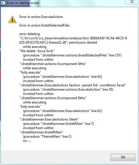

    During the install I got the following errors:
    I suggest you take the update off line until you have fixed this bug (installed today 6/5/12)!
