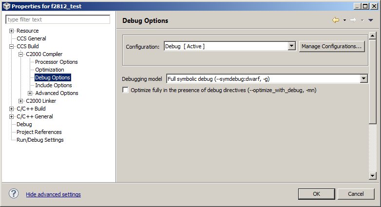

The code that I wrote for TMS320F2812 in CCS 5.1.1.00031 works fine in the debug build, but does not run as a release build. Please find the code attached below, as well as the text that appears in the build console for both build options.
With the debug build, no errors are created, only a warning appears in the Problems window saying
#10210-D creating ".stack" section with default size of 0x400; use the
The program works as expected.
When selecting release build however, after the program is loaded, another code tab opens next to main.c and it says in it
No source available for "main() at 0x3f629b"
What could cause this?
    In Release Mode, the -g option (full symbolic debug) is not enabled, therefore the symbol correlation with source file is not there. Typically the Release build is created/used after the program has been debugged and verified, and it is not necessary to still keep the debug information/symbols.
    If you want to get rid of that error and have source file correlation, add the -g option to the Release Mode build.
  • I found something related to the -g option in the menu
    Project | Show Build Settings | CCS Build | C2000 Linker | Advanced Options | Symbol Management | Don't make global symbols static if -h is specified
    where -g is given in brackets. But apparently one has to enter a list of symbols to which -g then applies. Is this what you mean? If so, what should be written into the list?
  • I was actually referring to the -g compiler option. Check attached screenshot for where you can find it.
