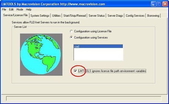

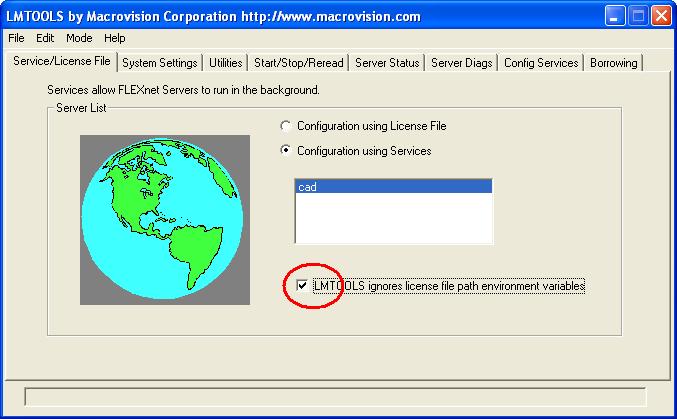

  • Hi Chien,
    I would google the error you get.  Unfortunately these flexlm issues are not always easy.
    One thing to try is to check box LMTOOL ignores license file path environment variables on Service/License file tab of LMTOOLS.   See the attached screenshot.
    Please keep us informed.
    Lisa
