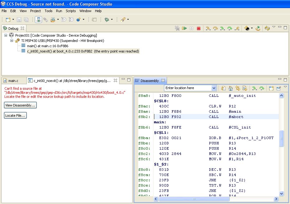

I keep getting the following message with every CCS (version 4 or 5) project that I create. Everything seems to be working as it should. I can step through the code, all the debugging features seem to work,  and the code runs fine in debug or release mode. I have included a screen shot to show the problem I am encountering. It appears that the CALL #abort at F8B2 has no corresponding label in the code. I am programming in C and using Grace. Any assistance will be greatly appreciated.

  • The source for abort is in the Run-Time Support library's source archive.  Unpack the RTS sources into a folder somewhere, then click on the "Locate file..." button and select the boot_4.0.c file where the RTS sources were unpacked.
    Usually, you shouldn't worry about what the RTS is doing.  In your example, the call to abort is done immediately after main() returns,  which is reasonable since your program has terminated.  If you were using SYS/BIOS, however, main() should have been called from a different run-time support function which after main() returns should enter a scheduler wait.

    1 - you should NOT add the source file to your project.  As Douglas mentioned you should simply click on "locate file .." in the debugger to locate and bring up the source file.  These run time library files should not be added.

    You will find several boot_x.x.c files in both the grace folder and the xdctools folder. Do a search on the folder where Code Composer Studio is installed and you will be provided with the path you need to follow when the message appears to locate the source file. Once you do this the locate source button will no longer appear. This does not add any code to your source file. I hope this helps.
