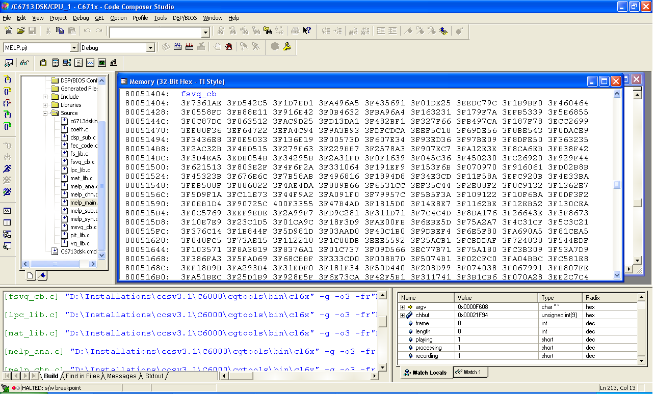

    Could you post a screenshot of the memory window displaying the first few entries of fsvq_cb in the "bad" case, showing the memory formatted as hexadecimal integers?

    Thank you for your reply, the screen shot is shown above. Regarding CCS I am using v3.1.0 and the compiler version is 5.1.0. Little Endian is used.
    I am sorry I want to correct that in the main file I made a copy ( fsvq_cb2[2560] ) not moved the original variable and this resulted in identical values, but moving it results in distorted values too.  When I modified the code to use fsvq_cb2 and leave fsvq_cb as an unused variable, the distortion is now in fsvq_cb2 and fsvq_cb is correct. What confuses me is that I make a break point and view the memory just after the program starts, so that the initialized variables should be untouched, beside I have not made any modifications to the core of MELP.

    Your screenshot verifies that the memory actually contains the bad values CCS claims that it contains, so I think that rules out a CCS memory window bug.
    What exact command-line options are you using?
    To proceed further, I'm going to need a reproducable test case.  Please post the first few lines of the defintion of fsvq_cb, exactly as it appears in the source code.  Please cut-and-paste, don't re-type it.
