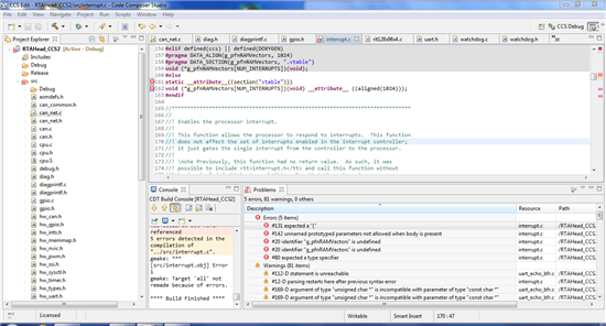

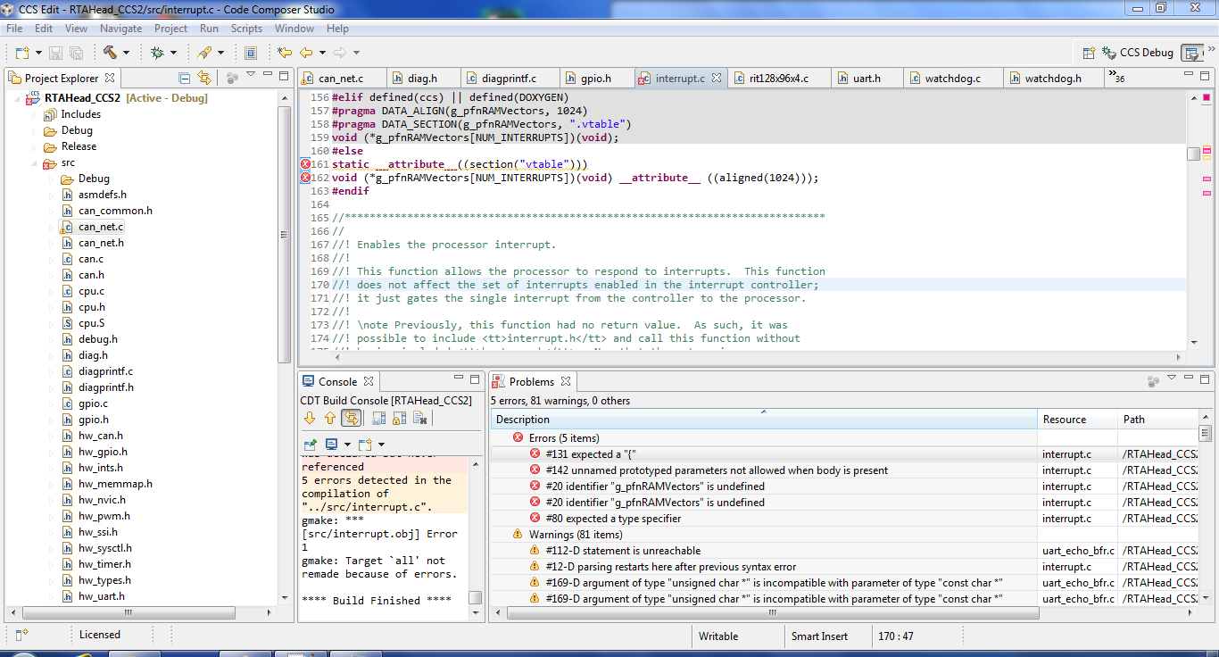

Build problem in CCSv5 after importing project.
I recently imported an eclipse project that I was working on before in a program called "Red Suite". I sucessfully imported it over to code composer suite and was able to run the debugger on my board. The issue that I'm having is that I cannot get the project to build. I'm assuming that the debug session is using a build from red suite. I think my problem might be that I'm missing a plug-in in CCS but I have no idea which one. I've attached my .log file that has some error messages in it, maybe someone could tell something from that?
-Dru

!ENTRY com.ti.ccstudio.project.ui 4 0 2012-06-14 13:02:32.463
!MESSAGE Import failed for project 'RTAHead' because its compiler definition is not available. Please contact support.
!ENTRY org.eclipse.cdt.managedbuilder.core 4 0 2012-06-14 13:02:52.127
!MESSAGE Orphaned CDT build configuration [com.crt.advproject.config.exe.debug.2001791599]: parent extension cfg [com.crt.advproject.config.exe.debug] not found

  • Dru,
    Although Code Red Suite IDE is based on Eclipse, it uses a completely different compiler toolset (and even maybe RTOS, other peripheral support libraries, etc.).
    Therefore, although the project itself could be imported fine (all files, project options, etc) the rest of the toolset mentioned above is missing (the log you sent reports that).
    If CodeRed uses GCC as their compiler toolset and the Eclipse standard GCC project support, it is possible to configure CCS to use it (check here) - never tested, though.
    However, if they instead use a proprietary plug-in to manage their project, then your best option is to try to re-create the project from scratch and use TI's tools. Keep in mind the source project may have some specific details that will require work to migrate (different linker command files, intrinsics, special keywords, etc.)
    Hope this helps,
    Rafael
  • Thanks, I'm in the middle of starting the project from scratch and I'm running into a few problems with the code for the TI tools.
    If this isn't the correct forum to ask this question could you point me in the right direction? In case it is, my problem is below.
    For the code section:
    (1)  static __attribute__((section("vtable")))
    (2)  void (*g_pfnRAMvectors[NUM_INTERRUPTS])(void) __attribute__ ((aligned(1024)));
    I get the errors:
    #131 expected a "{", line 1
    #142 unnamed prototyped parameters not allowed when body is present, line 1
    #80 expected a type identifier, line 1
    Then for anytime they use the g_pfnRAMvectors I get this:
    #20 identifer "g_pfnRAMVectors" is undefined.
    I get these errors when using Code Composer with both the TI tools and the other tools that I was using with code red.
    -Dru
  • Dru,
    Do you have the -gcc option enabled in the compiler options? This option is required to enable support for GCC extension by the TI compiler tools. Please also see this wiki for the list of GCC extensions supported by the TI compiler tools: http://processors.wiki.ti.com/index.php/GCC_Extensions_in_TI_Compilers. You also need to have a minimum version of the TI compiler tools are described in that page.
  • Sorry if this is a dumb question, but where do I check that the -gcc option is enabled? I'm very new to this, working as an intern. My boss just told me to take one program from Red Suite and move it over to code composer.
    Right-click on the project, go to Properties->Build->Compiler->Advanced Options->Language Options. Check the box for "Enable support for GCC extensions".
