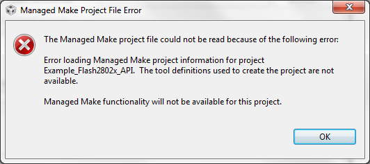

    I see this last post is somewhat old, but I am running into the same issue.
    I have downloaded the latest version of controlSUITE.
    I have two piccolo boards I am using.  A 28037 and a 28069.
    My CC version is 4.2.4.00033.  Code generation tool version is 6.0.1.
    I am trying to import C:\ti\controlSUITE\libs\utilities\flash_api\2802x\v201a\example_ccsv4
    and get the following:

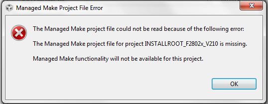

    If I try importing a project from C:\ti\controlSUITE\device_support\f2802x\v210
    I get the following:

    I guess I am wondering what version of the Code Generation Tool works with these projects??
    Is there a way to tell??
