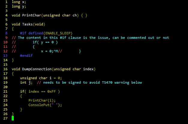

  • When I compile your downloaded 188D.c using v4.9.5 with the options you provide, I get this:
    "188D.c", line 24: warning #225-D: function declared implicitly
              ConsolePut(' ');
    "188D.c", line 19: warning #179-D: variable "j" was declared but never
              referenced
          int j;  // needs to be signed to avoid TS470 warning below
    The line numbers match what I see in the file:
  • That ^M (line 12) is mighty suspicious.  I bet some parts of Eclipse or the tool chain are counting that as a line break, and some parts aren't.
  • pf, I think you're correct, and it is a CTRL-M carriage return (0x0D) without a line feed and not the two characters ^ and M, which is very unusual for Windows.  Using a binary editor on the provided file, it is the only location that has 0x0D without the 0x0A expected on Windows.
  • I can say you solved this problem of errant line numbers.  I cannot guess how this happend, though the original code came from a third party.  I am pretty sure I did not touch this line - though I touched many others.  I am not sure how to even enter just a line feed.
    I search the third party code base I am porting, and this line alone has the missing line feed.  I have deleted the lone \r and just hit return.  The line numbers for errors in the original code now accurate.
