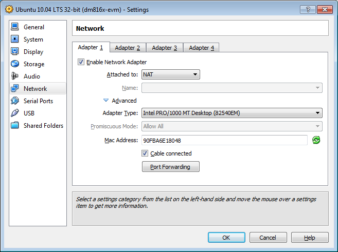

For more information here's my Virtualbox Network configuration. Everything seems okay, what could be wrong then?
