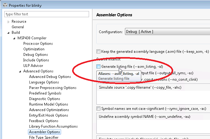

  • Hi Curt,
    The options are available in the project build properties (right-click on project and select 'properties' in the context menu). From there you will have to dig a bit to find the option you want. Initially it takes some time to get used to where the option you are looking is. For the option to generate a listing file with CCS:
    Note that there is tooptip help when you hover over a option. It should give you a description of the option, some with some pretty good descriptions.

  • Thanks for the help Ki-Soo.
    I'm able to generate a listing OK -- the problem is that it's not an "absolute listing" as described in the section of that name in the Assembly Language Users Guide (SLAU131G).   The absolute listing should show absolute addresses after the link step, where the listing created by the option in the Properties > Advanced Options > Assembler Options menu shows relative addresses (before linking).

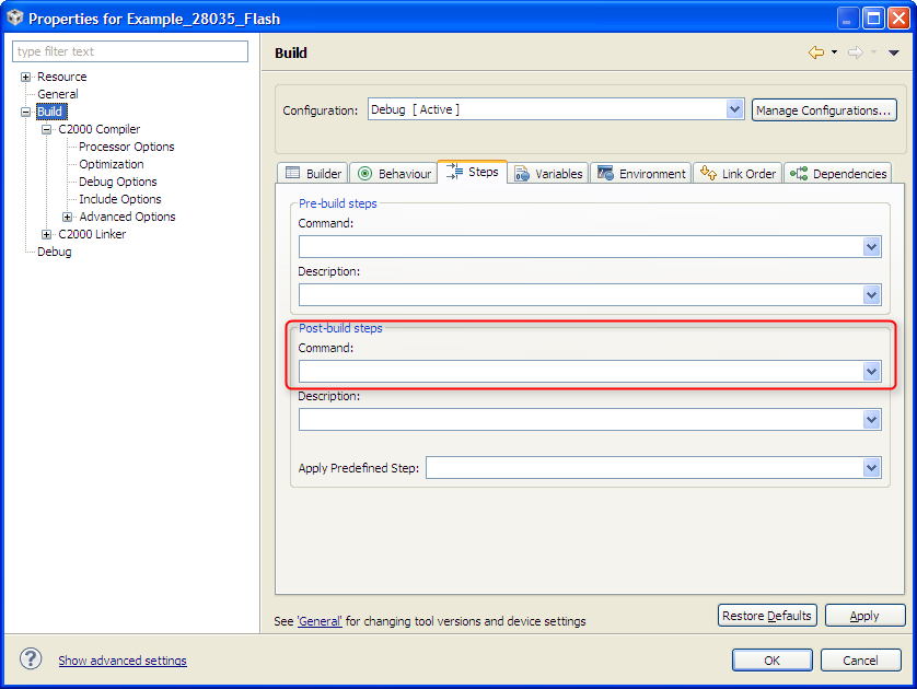

  • As Frank mentioned, these steps can still be run, although not currently integrated into CCS.  However, there is a way to add these steps into the build flow without forcing you to "remember" to do them.
    CCS has a provision to perform "Pre-build steps" and "Post-build steps".  You could add the above commands into a batch file and then have CCS call that batch file in the "Post-build steps" section.  You can access this by going to Project->Properties, selecting the Build category on the left window pane and then select the "Steps" tab on the right window pane.

  • Frank:
    Thanks -- that's very helpful.  I haven't had a chance to try it in detail yet -- but you've given me a starting point and I think I can find my way from there.
    I can certainly imagine that it's a HUGE job to try to keep all the documentation synchronized!
    For anyone that should happen to follow this struggle later:  the abs.exe program that Frank refers to in his step-by-step guide can be found in the  folder                           ccsV5\tools\compiler\_4.1.0\bin
  • Thank you Brandon.  I'll give putting the commands in the post-build steps a try once I have the basic process working.
