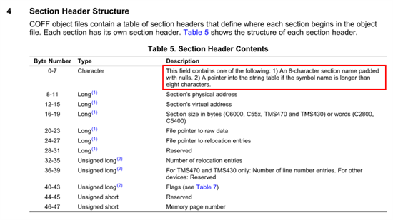

Pointer in section header of COFF file
i am trying to make a COFF file parser based on the SPRAAO8:
http://www.ti.com/lit/an/spraao8/spraao8.pdf
I have a question about how the pointer in "Character" bits of Section Header structure be interpreted:
For example when i try to parse the following COFF out data for MSP430:
http://e2e.ti.com/cfs-file.ashx/__key/communityserver-discussions-components-files/343/5047.BLINK.out
for the first section i got the following data:
Sect Hdr 0:
00 00 00 00 7D 02 00 00 00 00 00 00 00 00 00 00 6F 00 00 00 22 07 00 00 00 00 00 00 00 00 00 00 00 00 00 00 00 00 00 00 10 00 00 00 08 00 00 00
Chars : 00 00 00 00 7D 02 00 00
Phy addr : 00 00 00 00
Virtual addr : 00 00 00 00
Size : 6F 00 00 00
Raw data ptr : 22 07 00 00
Reloc entry ptr : 00 00 00 00
Reserved : 00 00 00 00
Num of reloc ent : 00 00 00 00
Num of line ent : 00 00 00 00
Flags : 10 00 00 00
Reserved : 08 00
Mem page num : 00 00
The question is how shall i interpret the 00 00 00 00 7D 02 00 00 in the Character field?

  • To repeat, the eight bytes are: 00 00 00 00 7D 02 00 00
    As the first character is a NUL, this is clearly not a string, so it is an offset into the string table.  The first four byte are padding.  The last four bytes are a 32-bit little-endian value, so the offset is 0x27d.  The address of the string table is 0x2d68, and 0x27d+0x2d68=0x2fe5, so the section is "$build.attributes"
    You should double-check your results with the output of "ofd430 -v BLINK.out"
