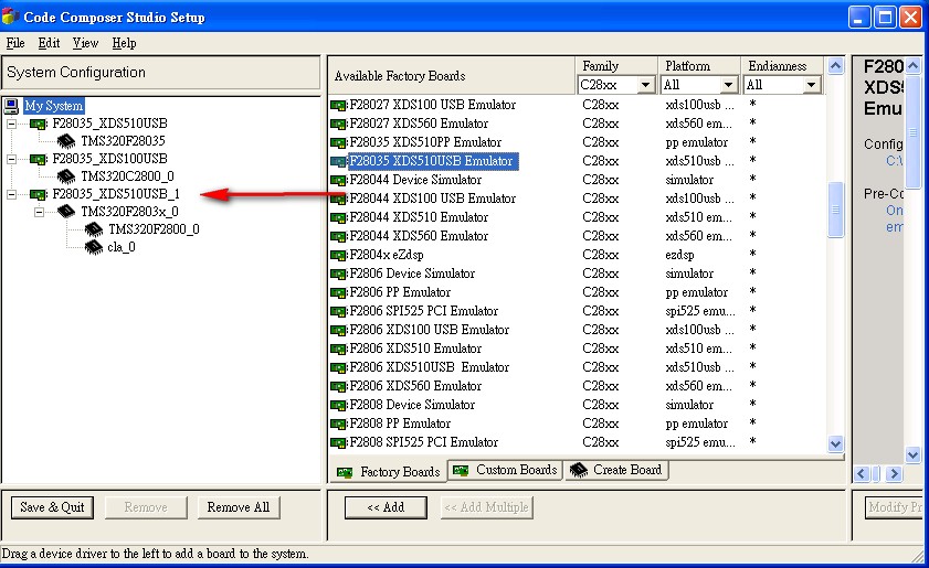

Does anyone every run Code Composer Studio 3.3 on XP mode of Win 7? I've tried both 32-bit and 64-bit Win 7 machines but got the same error message when start CCStudio 3.3. Here is the error message I got.
After I click OK button, the program just ended. I've checked that folder, there is no F2803x.xml. My other installation on VMware environment works just fine. The reason I want to transfer it to XP mode is that I found my XP on VMware runs quite slow, but it runs faster in XP mode. Does anyone have idea what's going on with this error message?

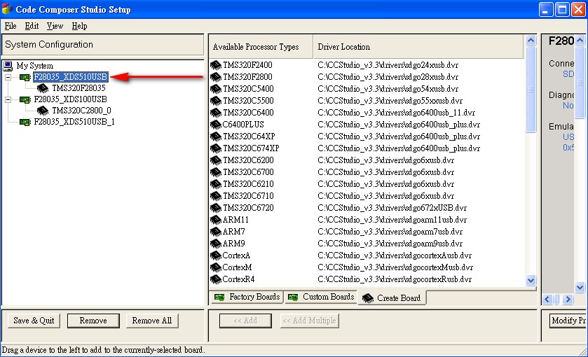

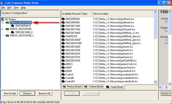

  • Problem solved.
    The problem is at "Setup CCStudio v3.3".
    When creating a board, it looks like the this.
    Delete all devices manually and just add the device back. It then looks like this.
    The problem has nothing to do with XP under MS VirtualPC or VMWare environment.
