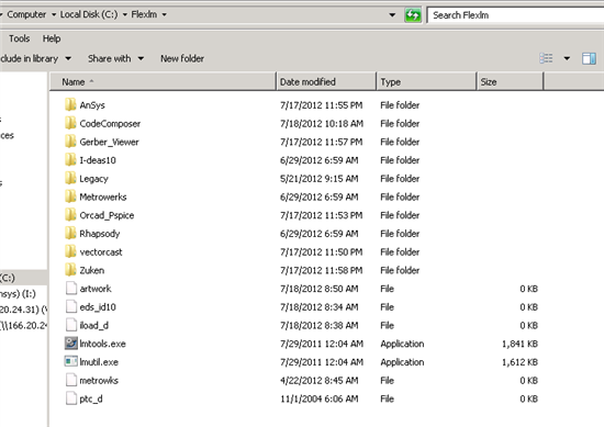

  • HI Alex,
    are there any further details you can provide?  Have they looked for the tidspssw log in the license server installation folders?  These will not be in the ccs folders.
    LIsa
  • Hi Lisa,
    2 pics attached. Second has appCrash.
    No file in there…

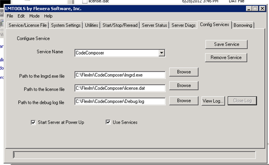

  • Hi Lisa,
    Yes, they have a flexnet server running on that server.
     LMTOOLS.exe  runs 9 other FlexLM licenses on that server and that is what he is trying to use for CCS.
    Thank you,
    Alex
  • Hi Alex,
    ok we still need details on how they set up the CCS license.   ..... How they tried to add it, what they experienced etc .. .any details would help.  How did they try to install the vendor daemon.
    LIsa
  • Hi Lisa,
    Does the screen shot below help?
  • Hi Alex,
    have they started the server?  What do they see under status?  How did they set this up?  We still need the details.
    Lisa
