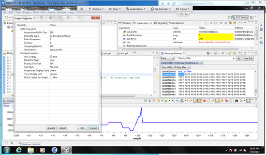

I'm trying to use the graph Single Time tool in CCS 5 and it's not working for me. I've attached a picture with my settings and the graph that I am getting.

Picture with my settings:
    I don't see anything particularly problematic with the graph parameters, therefore the first thing is to compare the actual memory contents with the graph display: open a memory browser view and point to the buffer, so you can compare the values in memory. If the values match, you then have a problem in your algorithm. If not, then try to put an ampersand (&) in front of the name of the variable (I recall that some versions required this, but I can't recall which ones).
    Also, keep in mind that using signed values on the graph may cause it to jump around, especially if you have alternating negative values (larger than 0x80000000) and postitive values (up to 0x7FFFFFFF).

  • I tried a few of your suggestions and I still can't get the thing to graph.
    The iterator is working fine, I can see my values changing in the buffer both in the expressions window and the memory browser.
    When I add an ampersand in the graph property pages nothing shows up on the graph at all, even though I can see the correct values in the memory browser.
    AxisW.Position is the position of a physical servo motor, so I can change it whenever I want. It has the expected values every time.
    The one thing I did notice is that every iteration, in memory it only updated 4 hex values, one iteration will be like:
    0x0000D940 FFFF FFFF FFFF 1C32 FF9A D8B0 96B0 ...etc
    and the next iteration is:
    0x0000D940 FFFF FFFF FFFF FFFF FF9A D8B0 96B0
    This happens when AxisW.Position is a constant value of -1, hence the FFFF. Does this mean that it is a 16-bit value somehow?
  • Heres a few screenshots of whats happening:
    My Properties screen again:
    The corresponding graph and memory window:
    As you can see, the graph is telling me that my values are ranging from -22000 to 23000, when in reality they are ranging from about -5 to 5.
  • So in the properties I changed it to a 16 bit value and it seems to be working fine now.
    Yes, you figured that out. The reason why the graph was showing a lot of garbage closer to the end is because it was set to display two times what you actually had as valid data in memory: the data was 16bits x length of buffer (2 bytes X 500 = 1000 8-bit bytes), but the settings were for 32bits x length of the buffer (4 bytes X 500 = 2000 8-bit bytes).
