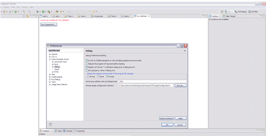

  • Rafael,
    Thank you for your reply, I have a couple of questions before I can make progress:
    1- Under Run > Advanced do I need to check or uncheck the Halt On Reset I am not sure which one?
    2-I opened the video you mentioned however my menus look different, please take a look at the snapshot provided. I am not sure how to enable the ICEPICk under these menus?
    thx,

    1. The error message talks about halt on reset possibly being enabled, therefore the ideal option is to disable it.
    2. Sorry about the short clip, it was designed for CCSv4 and I forgot that CCSv5 is radically different. The forum thread below talks about how to use the ICEPICK in CCSv5 (I still need to do a short clip about that).
    http://e2e.ti.com/support/development_tools/code_composer_studio/f/81/p/195554/699454.aspx
