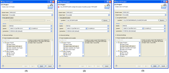

Hi CCS Team,
is it possible to create a project which has different name than the directory which is created for the project? I am using the latest CCS v5.2.1. When i tried to use other location besides the default one, it always give error
  • So, i guess i found a workaround. I can't make the new project with different name on the folder which resides directly in the workspace folder, but i need to make it one folder under the workspace folder.

  • Hi Lisa,
    so what i was trying to do is basically this:  let's say i want to create a project named as "MyProject". Per default ("using default location" option is unchecked), CCS will create this project under <WORKSPACE_PATH>/MyProject -> basically the project folder is named as the Project name.
    However if i want to have a different name for the project folder, let's say MyFolder, i can't make the folder directly under <WORKSPACE_PATH>/MyFolder (at least this is the result from my test). I need to specify the folder one level under the workspace folder, which mean something like this: <WORKSPACE_PATH>/Intermediate_Folder/MyFolder.

  • Hi Lisa,
    sorry, it was a type, i did uncheck the "use default location". I made a screenshot for this. The workspace location is at C:\A_TEST (you can see the .metadata folder created by CCS below):
    and then these are the screenshots from the CCS create project:
    as you can see above:
    (1) the default project folder is C:\A_TEST\MYPROJECT
    (2) if i put C:\A_TEST\MYFOLDER as the project folder path, it will be rejected
    (3) putting C:\A_TEST\INTERMEDIATE_FOLDER\MYFOLDER will be accepted.
    Can you confirm this again?
  • Hi Leo,
    yes we see the same thing and this is eclipse behaviour as mentioned.  For whatever reason eclipse cdt does not like using the workspace folder.  You do not need the intermediate if you go outside the workspace folder.
