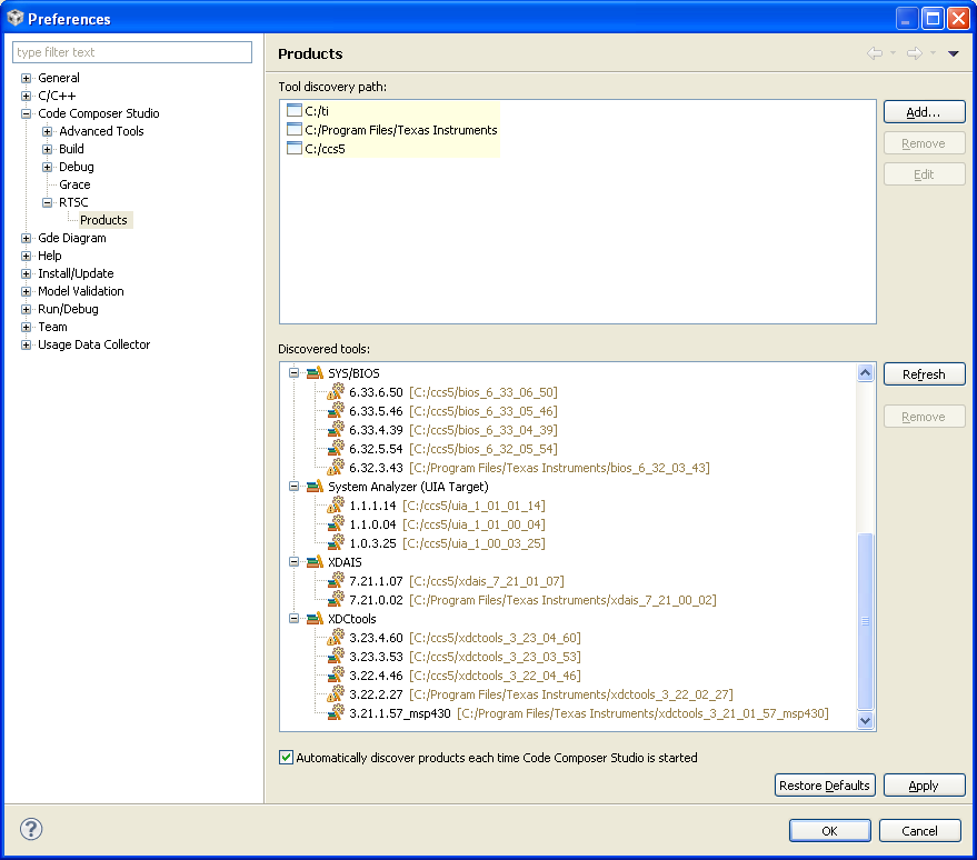

CCS 5.2.1.00018, Windows XP
CCS is installed in C:\CCS5
I unzip the NDK (ndk_2_21_01_38) into C:\CCS5 so it is in parallel with the SYS/BIOS, XDCTOOLS, etc.
Start CCS5.
I never see a "new feature detected" prompt.
Go to Windows / Preferences / Code Composer Studio / RTSC and the NDK is not there
Go to Windows / Preferences / Code Composer Studio / RTSC / Products and the NDK is not in the discovered tools list.
Add C:/ccs5/ndk_2_21_01_38 to the Tool Discovery Path, hit Refresh. The NDK is still not found.
If I unzip NSP_1_10_00_03 into C:\CCS5 it is discovered properly, but when I try to have CCS install it I get an error:
Operation details
Cannot complete the install because one or more required items could not be found.
Software being installed: NDK Network Support Package (IDE Client) 1.10.0.03 (com.ti.rtsc.NSP.product.ui.feature.group 1.10.0.03)
Missing requirement: NDK Network Support Package IDE Tooling 1.10.0.03 (com.ti.rtsc.NSP.product.ui 1.10.0.03) requires 'bundle org.eclipse.ui 0.0.0' but it could not be found
Cannot satisfy dependency:
From: NDK Network Support Package (IDE Client) 1.10.0.03 (com.ti.rtsc.NSP.product.ui.feature.group 1.10.0.03)
To: com.ti.rtsc.NSP.product.ui [1.10.0.03]
Any ideas on how to make it install?
