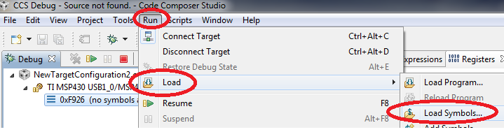

  • I'm trying to do the same thing but on a msp430f5438a.   I have code running that I want to look at with the debugger as well as the EEM tools.
    But when I try to mess with Run -> Load -> Symbols, there is no such menu entry.
    Is there a way to fire up a project-less debug session with CCS for msp430f5438a
    I'm running the latest CCSv5.
  • Eric - the use case is the same for MSP430. You should see the menu under 'Run -> Load -> Load Symbols'. Also make sure you are in the 'CCS Debug' perspective.
