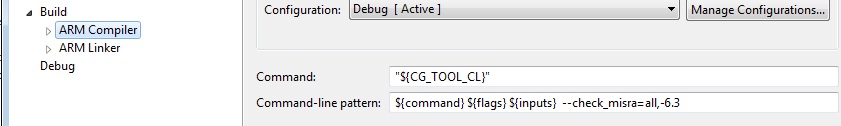

    You can manually add it to the build options.  First, disable all misra checking.  Then manually add in the desired --check_misra option.  Details on that option are in the section titled Using MISRA-C:2004 in the ARM compiler manual.  In the screen shot below, I enable all misra checks, except for rule 6.3.

    Regarding George's earlier work around.  There's an issue with putting the check_misra in "command" box versus "command-line pattern" box.
    If you do below, and have misra options all checked, or even just rule 6 checked, you get something like this.  The 2nd check_misra entry overrides the first so you just get all rules.
                     cl6x  ....   --check_misra=all,-6.3   ....   --check_misra=all  .....   files
    Instead try doing below.  It places your overrides at end of options.  You get this:
                     cl6x  ....      ....   --check_misra=all  .....   files    --check_misra=all,-6.3
