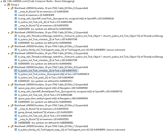

  • After having validated that all my other loops execute the same way (only one iteration on core 0, all others on core 6) I have the feeling something is going wrong here.
    When executing the following code as part of a standalone-project, everything works fine - each core immediatly gets it's amount of work:

    However, as part of my openmp project, I get the behaviour described above with only core6 doing work, while all other cores seem to sit idle with the following stack:

  • Clemens,
    Just to make sure I understand you correctly - When you try a simple standalone OpenMP project (say, A), the 8 threads are evenly distributed across the DSP cores. This is expected behavior of the C6x OpenMP runtime. However, when you run your OpenMP project (say, B), the threads execute only on cores 0 and 6?
    Do you have any schedule clauses on your OpenMP directives in project B? Is there code outside of OpenMP that initiates tasks on the cores?
    Ajay
  • Hi Ajay,
    Exactly, in project A thread distribution works well, in project B the first iteration takes place on core0 and all subsequent ones only on core6.
    There are no schedule clauses or omp-behaviour altering calls to the runtime, and no other tasks involved - its just a simple ~10 lines main file.

  • Did some testing - the binary works as expected on the simulator, the problems I observe only occur when running on my EVM6678 (rev 3, silicon 2).
    Just double-checked, I am using the gel-file supplied by the OMP package on all 8 cores.
    Also, I reverted all my placement settings, this is the gerenated linker.cmd-file: 1374.linker.zip
    Any ideas how to diagnose this issue further?
    Would it help to upload a precompiled test-binary which triggers the issue?
    Thanks a lot, Clemens
