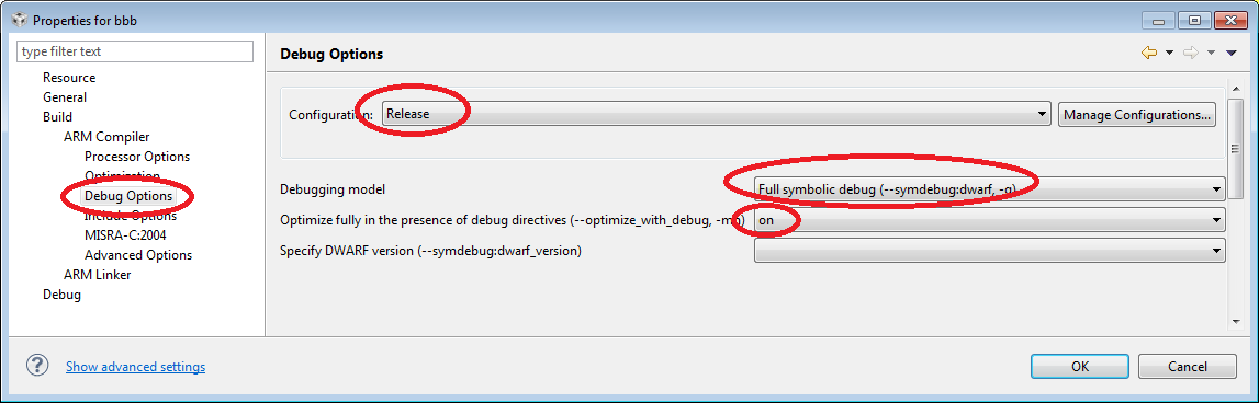

I use profiling now. I find that it only work in Debug (not release) configuration. Is it true? When I change to Release, there is no debug info, the profiling cannot work. Thus, this profiling is only a raw estimation, right? Please correct me if you know these issues.
  • Robert,
    By default the release configuration will not have enough debug information to do function level profiling.  You could still use the profile clock.
    What you could do is change your release configuration to have full debug information (-g) but then also turn on optimization with debug.  This will enable you to then profile optimized code, the optimization is not as good as when -g is off but it is pretty good.
    John
  • I should revise my post.  To do function profiling you need to have a minimal amount of debug information.  I was just trying this out and skeletal debug information is enough.  So you don't need to turn on the full symbolic with optimize_with_debug.  You need that one if you want to be able to do any debugging.  But if you just want to profile then skeletal debug information is enough.  That should be the default value for the option if nothing is specified.  However you can also explicitly set it if you want.  Below is a capture of the option.  My previous capture was for ARM but I think you are on C6000 so this one is for the C6000 options dialog.
