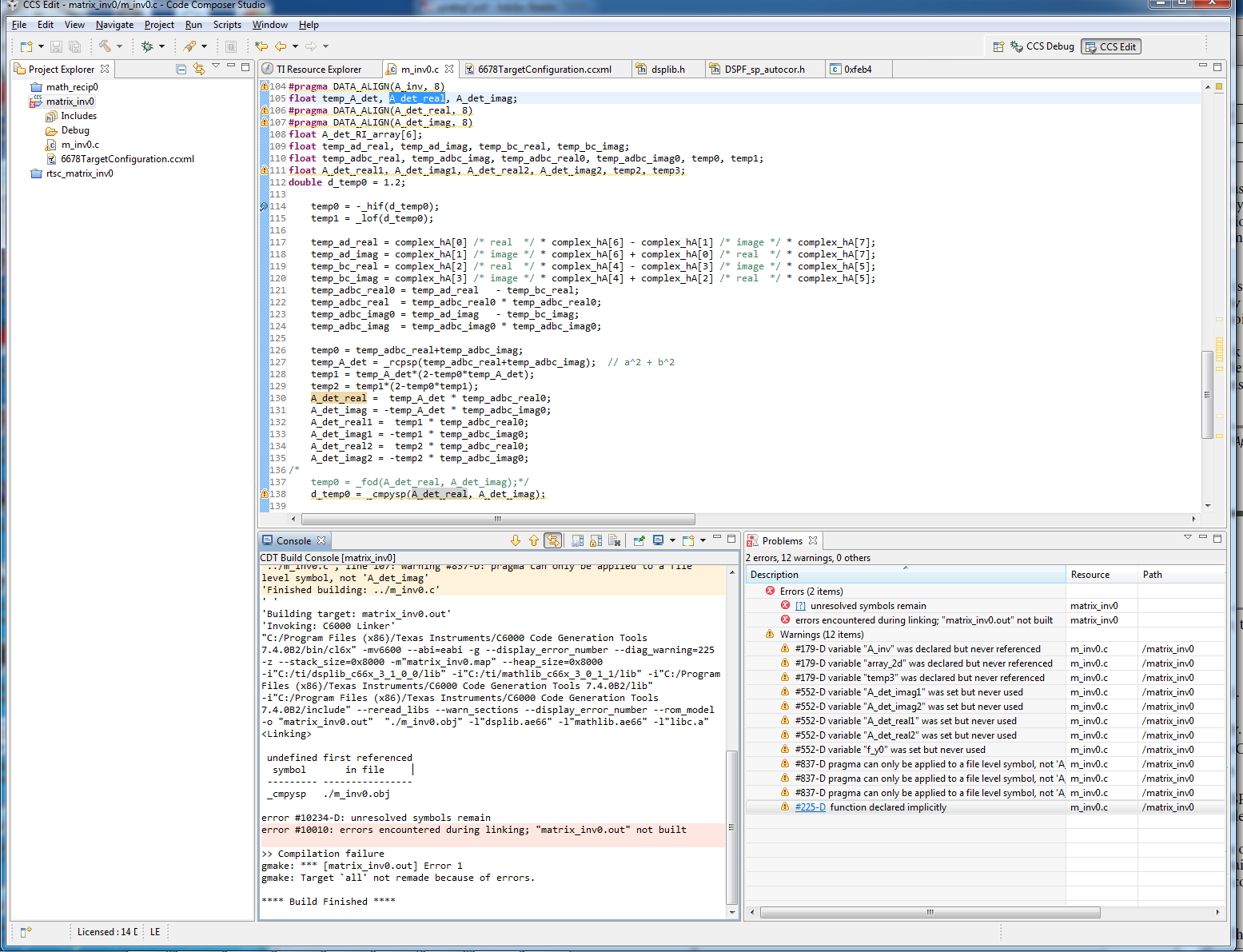

temp1 = _cmpysp(A_det_real, A_det_imag);
It gives a function declared implicitly warning.
. Anyone can tell me where I can find that? Or, you can tell me what that intrinsic is.

    The compiler has the option of -mv6600. This, and other variable definition, _cmpysp() and the link error all can be seen from the below picture.
    What is reason for the link error on my CCS v5?
    Thanks.

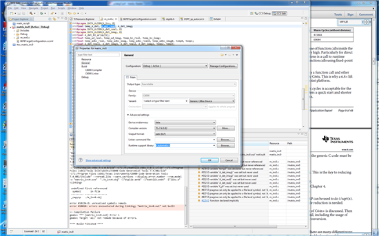

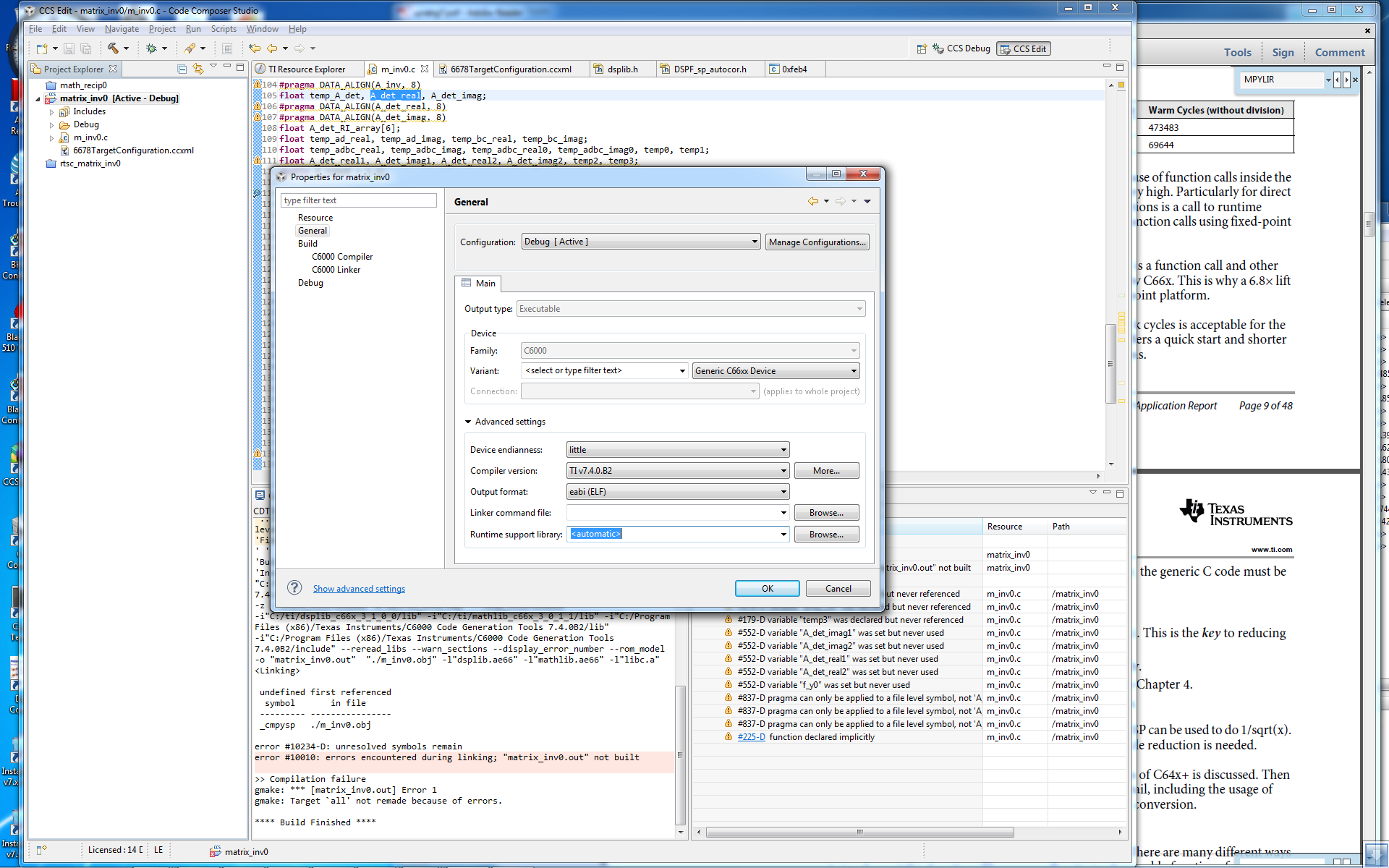

  • I am not clear about the rts library settings. I also have tried rts6600_elf.lib in the "Properties for matrix_inv0/General", it doesn't work either instead of "<automatic>". What is the relationship between rts6600_elf.lib and -mv6600?
    The _cmpysp intrinsic takes two __float2_t types as input and returns a __x128_t type. For this to work please include c6x.h to your source file and make sure the return type is __x128_t (this type is documented in section 7.5.6 of the Compiler Users Guide).
