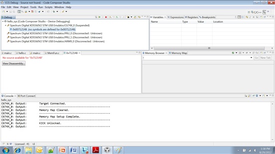

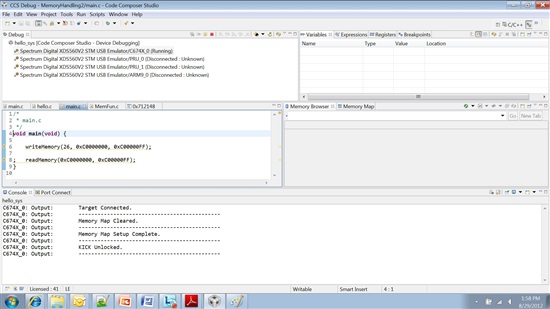

  • Can you post a screenshot of the target running and also when you halt it?
    ki
  • Sorry I took so long, I tried to unsintall and install code composer studio again to see if the problem got fixed since my coworker was able to debug from his computer. Yet the problem persisted.
    When connected but cannot debug:
    When halted:
    Michelle
  • Hi Michelle,
    According to your screenshots, you are actually in a successful debug session. I assume you are hitting the green debug button. That would build your project, start the debugger, connect to the target, load the program and run to main. You first screenshot tells me all the steps were successful except the run to main. hence the target is still running. When you halt the target, the program is in some area where there is no source code for it (it may have gone into the weeds or it may be optimized code with no symbols generated for it).
    So basically you have successfully started a debug session for the DSP of the L138, successfully connected to it and loaded code and is running.
    What you need to determine is why the program never made it to the main of your program. I would disable the 'autorun to main' feature and then reload the program. That would simply have your application at the entry point. Then you can try debugging to see why your application never gets to main.
