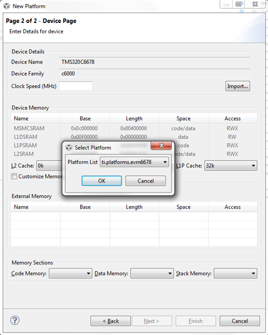

    File -> New -> Other or type Ctrl + N
    Then choose RTSC -> New RTSC Platform
    You can also do that  while you're in the Debug perspective in the Tools menu:
    Tools -> RTSC Tools -> Platform ->New
    Click Next and you will see the window like this
    Choose the Package Name, the Platform Repository and Device Family and Name, in this case it's 6678.
    In the second window I suggest that you import the default platform
    Customize the new platform as you want.

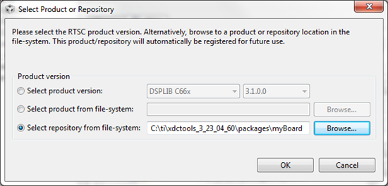

    When you create a new CCS project or if you edit a project that already exists go to the RTSC configuration tab and in 'Product and Repositories' click' Add'
    Choose 'Select repository from file-system' it should be in somewhere like this:
    C:\ti\xdctools_3_23_04_60\packages\myBoard, depending where your XDC tools directory is
    When you click OK and go back to the RTSC configuration you see it in 'Other Repositories' and can choose it in the 'Platform' below
    Click OK and go on with your project normally.
    Hope this is what you're looking for.
