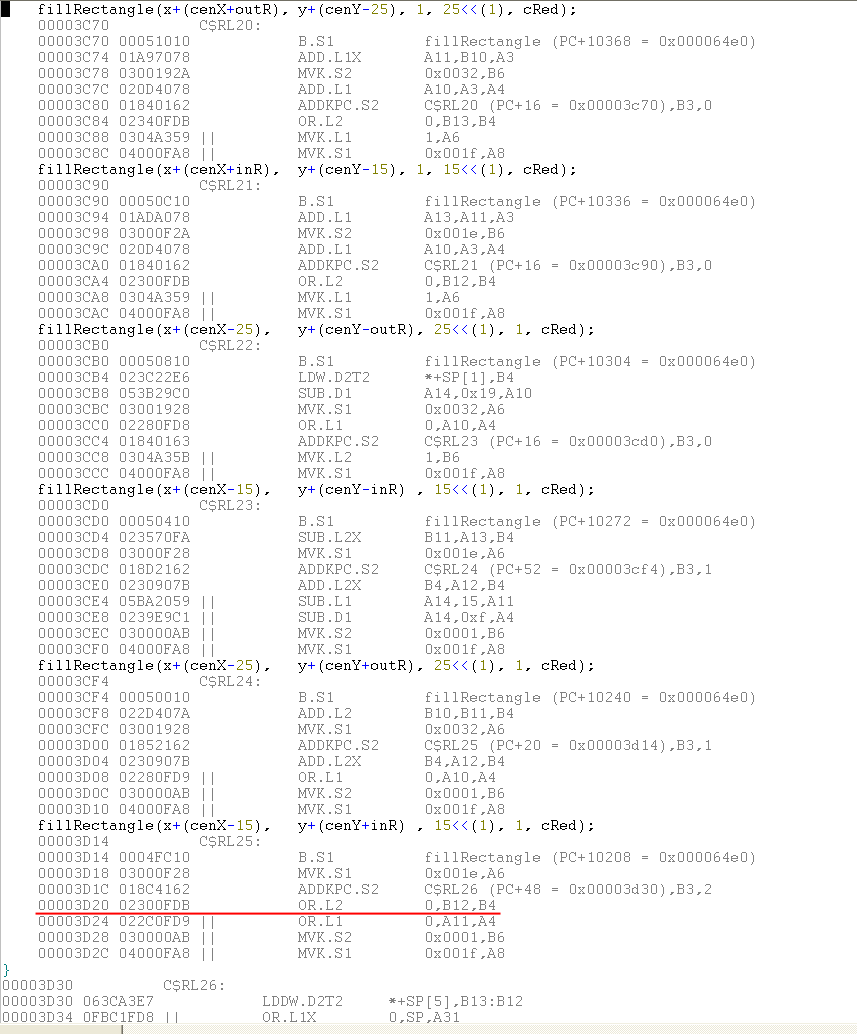

Bug in C6000 Code Generation Tools v6.1.21
CCS3.3 SR12, with C6000 Code Generation Tools v6.1.21
wrong parameter in the last function call.
//source code: draw a cross and double lines at the end of cross
void drawCrossLine(int x, int y, int cenX, int cenY,int outR, int inR)
    fillRectangle(x+(cenX-outR), y+cenY, outR<<(1), 1, cRed);
     fillRectangle(x+cenX, y+(cenY-outR), 1, outR<<(1), cRed);
     fillRectangle(x+(cenX-outR), y+(cenY-25), 1, 25<<(1), cRed);
     fillRectangle(x+(cenX-inR),  y+(cenY-15), 1, 15<<(1), cRed);
     fillRectangle(x+(cenX+outR), y+(cenY-25), 1, 25<<(1), cRed);
     fillRectangle(x+(cenX+inR),  y+(cenY-15), 1, 15<<(1), cRed);
     fillRectangle(x+(cenX-25),   y+(cenY-outR), 25<<(1), 1, cRed);
     fillRectangle(x+(cenX-15),   y+(cenY-inR) , 15<<(1), 1, cRed);
     fillRectangle(x+(cenX-25),   y+(cenY+outR), 25<<(1), 1, cRed);
     fillRectangle(x+(cenX-15),   y+(cenY+inR) , 15<<(1), 1, cRed);
Mix Source/ASM:
At the last call of fillRectangle(), use B12 stand for y+(cenY+inR) @00003D20. However B12=y+(cenY-15) @00003C60.
The result of C6000 Code Generation Tools v6.0.8 is correct. It use two ADD instruction to caculate y+(cenY+inR) @000031B8 and @000031C4

  • Exactly what command line options are you using?
    What is the definition of cRed?
    The optimizer segmentation fault involving FS_selfExamine is a separate bug.  Could you post that function here so we can analyze that bug, too?
  • I simpified my project and make sure error appear and can run in DM642 simulator.
    5810.App_IDOIV20Test.zip
    Options=-g -pdsw225 -o3 -fr"$(Proj_dir)\Debug"  -d"_DEBUG" -mf3 -mv6400 -c
    Without -mf3 option, the result asm is different but same error apears in drawing result.
    Segmentation fault involving FS_selfExamine didnot apear with 6.1.11 and 6.1.21, so it would not a problem.
    I would turn to 7.3.x, so this problem would not bother me no more.
  • I was able to reproduce a failure with the test case and options given.  I haven't proven this conclusively, but it is extremely likely that the bug is SDSCM00043966, which was fixed in 7.2.10, 7.3.6, and 7.4.0, but will not be fixed in 6.1.x.  The versions of the compiler which carry this bug match with your observations about which versions fail, and the description of the bug matches your test case.
