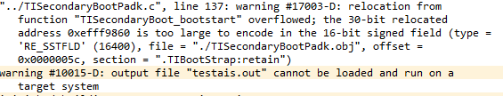

I'm trying to build a project about TMS320C672x Secondary Boot on the following system:
TMS320C6727
Code Composer Studio  Version: 5.1.0.09000 and the compiler version is 7.3.1
Spectrum Digital XDS560V2 STM USB Emulator

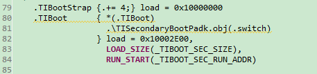

I came across with  two warnings in the linker Command file . Here is the code.

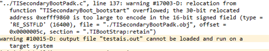

When linking, there are two warnings:
TISecondaryBootPadk,cmd is the linker command file.  TISecondaryBootPadk.c is included in the project.
Could anyone help me understand  where is the mistake?
Lina
  • The first warning indicates that none of the input files or libraries seen by the linker have an input section with the name .TIBoot.
    The second warning indicates the file .\TISecondaryBootPadk.obj does not have any input section named .switch.  I presume this is the .switch section generated by the compiler.  The compiler does not always generate a .switch section.  The .switch section contains jump tables related to switch statements.  However, not every switch statement is implemented with a jump table.  Thus, it is possible to have a source file with switch statements but no .switch section.
    Thanks and regards,
    -George
  • Dear George
    Thank you for your reply
    As for the first suggestion, I have attached a  input file named TISecondaryBootPADK.c to this post, which has a section with the name .TIBoot.

  • Mybe in your executable  there are not direct references to symbols allocated into that sections, so the linker remove it leaving the section empty. Look at the executable map file to see if the functions are linked.
    If not present, try to add some a #pragma RETAIN or link with "--unused_section_elimination=off" (Linktime optimization settings)

  • In the map file you shuold search the symbols you expect to be allocated into, not for the sections. For instance, sarch TISecondaryBoot_parseAisStream.
    If one or more of these symbols are present, forget about my suggestion, oherwise it means the linker haven't link in your code.
    Have you tried with "--unused_section_elimination=off"?

  • I have tried the #pragma RETAIN and the example you mentioned. Both of them come across a warning:
    The warning is highlighted as follows。
  • I suppose the compiler assume TIBOOT_SEC_SIZE is near, while it is actually far and so cannot be addresed as a near 16bits offset.
    Try to declare it af far:
    extern far unsigned int TIBOOT_SEC_SIZE;
  • After I declared it as extern far unsigned int TIBOOT_SEC_SIZE, there is no warnings.Thank you very much.
